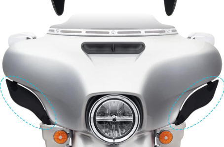

The new bikes come with fork-mounted air deflectors which work well in moderately cold weather. Our HOG group went out on our New Year's Day ride in sub-40 degree weather and, even with layering and a heated jacket, the air blowing up from under the fairing at highway speeds made my chest very cold. I'll figure out a workaround for now, but it got me thinking about the older bike's fairing mounted defectors. Does anyone know if there are any aftermarket deflectors that would fit the new fairing?
If there were fairing lowers like the previous twin-cooled have, that might be the fix but there's nothing yet.

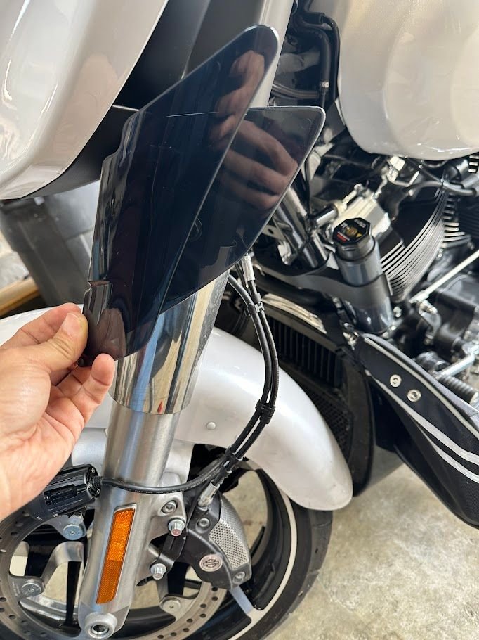

I know DK Custom sells a tank lift kit and cooling deflector wings designed to allow more air flow under the tank and over the top of the engine to reduce buffeting. In addition, it allows the engine to run cooler with this increased air flow. As per DK, they both work in tandem to redirect the air flow hitting the rider and passenger from underneath.
As far as fairing lowers, I haven’t seen no such animal as of yet.

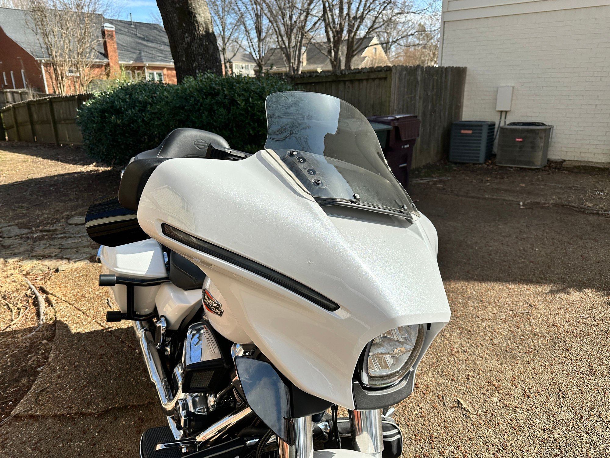

This is what I had in mind:

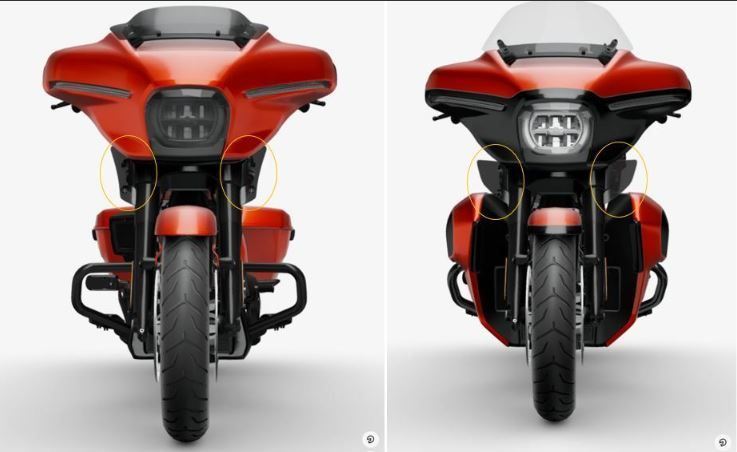

This is a follow-up to one of my posts from a few months ago. Just wondering if anyone has heard of any OEM or aftermarket solutions.
Thanks!
"One of the very few things I'm not crazy about with the '24 Street Glide (left) is the anemic performance of the air deflector "wings" that mount on the lower side edges of the fairing. Even when fully extended, a TON of air comes rushing up from under and around the gas tank.
Not looking for the air to be still as a crypt but I would welcome at least a bit more protection and less wind noise. I've already upgraded the windshield and while it's been light years better than stock, it can only do so much on its own.
HD redesigned the wings for the '25 Street Glide Ultra (right) and I'm wondering if was, in fact, an improvement. Anyone out there who's ridden 'em both and can comment on their comparative effectiveness?"

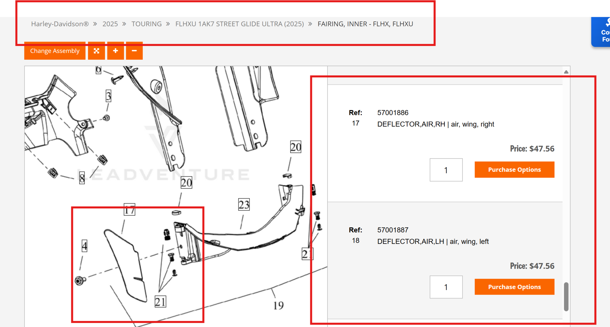

I installed the larger wings recently and after coming back from my first long trip two days ago, a 2,400 mile run from West TN to Miami and back, I can definitively say that yes, they are noticeably better.
The bike is a 24 SG and though it doesn't have the new lowers (yet), it does have engine guard chaps and the new Freedom Shields 13" screen, so my assessment includes all three mods. Nice thing is they are a direct replacement for the OEM deflectors so you only need to buy the left and right wings and reuse the OEM friction hinges.
The HD part numbers (item 17 in the image, 18 for the other side) are 57001886 and 57001887 that cost $48 each. You DO NOT need to purchase item 21 or item 19 (the entire assembly) so don't let your parts person tell you you do. I posted detaild installation steps elsewhere so search for my user name.
