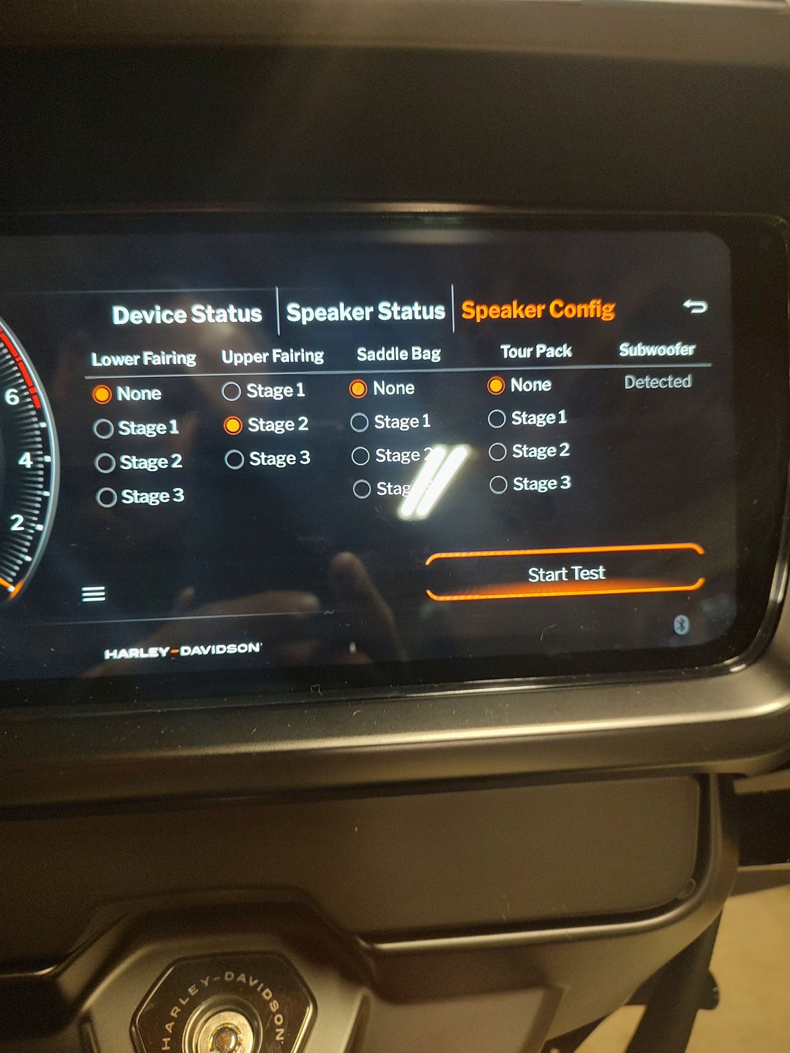

Well I just did the update with the USB 2 my OS is 5057D . And my amp is 1540 I have stage 2 with fairing speakers only. I'm I correct that this update is correct... Thanks for your time....swifty

Its the amp update I'm thinking about. My amp now shows Fairing speakers ,lower and saddle bag and I think touring trunk speakers or something like that. I only have stage 2 Fairing speakers and amp. I thought that this update only changes what hardware you can choose and not a actual amp update. I will post a pick when I get home
