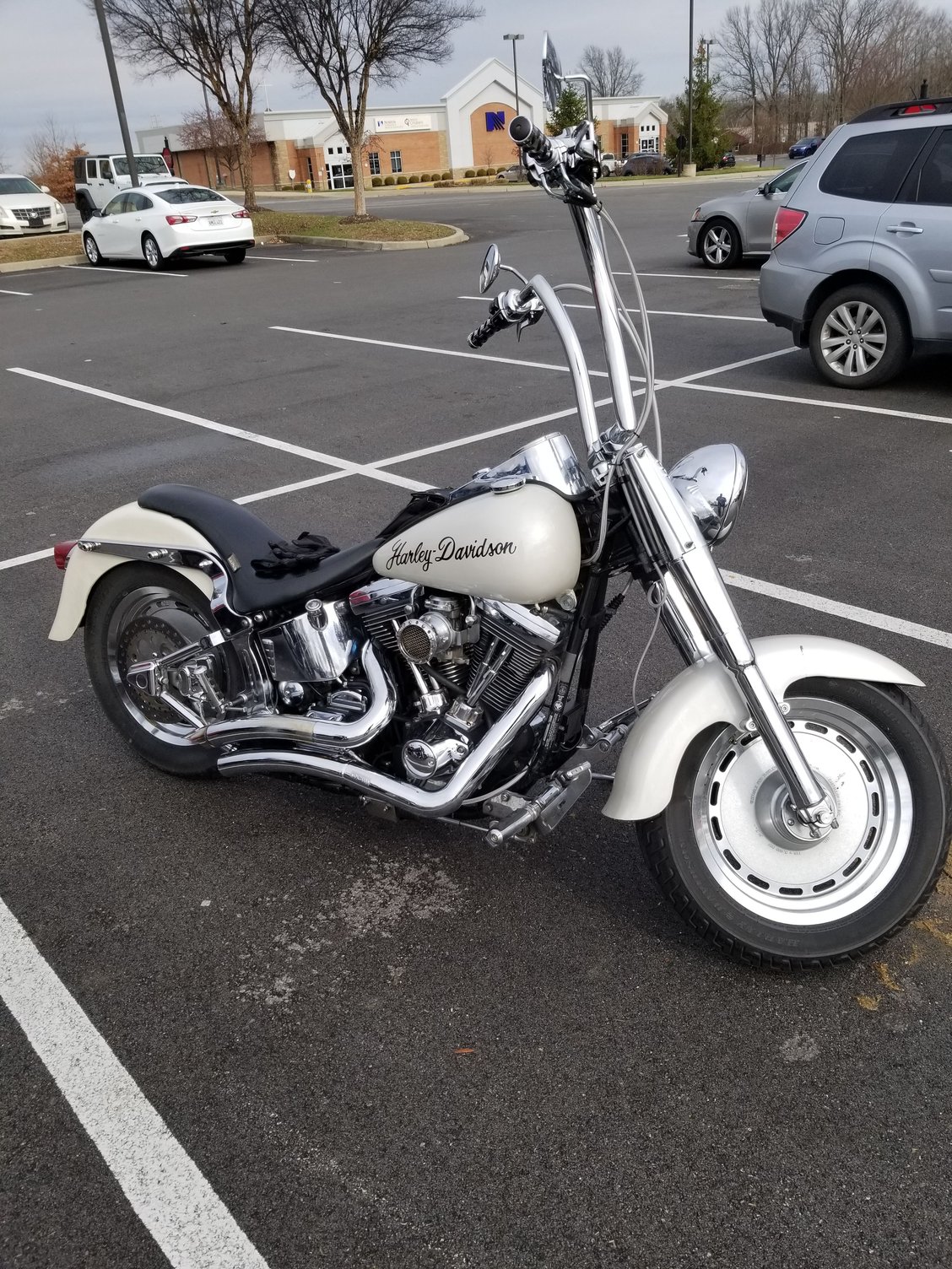

Thank you so much! This bike has been in half the states, then stolen and they totaled it. I'm not a broke man, and don't know another bike I rather be on! Too much History!
Old Jan 9, 2022 | 07:30 PM
Ingramite's Avatar
Ingramite
Joined: Mar 2021
Posts: 1,153
Likes: 1,283
From: Texas Hill Country
Yeah, it looks bad azz man!
Nothing like an EVO.
