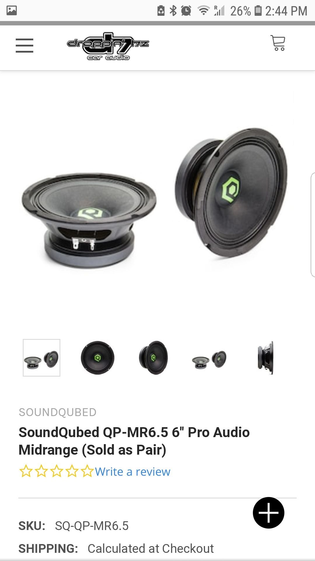

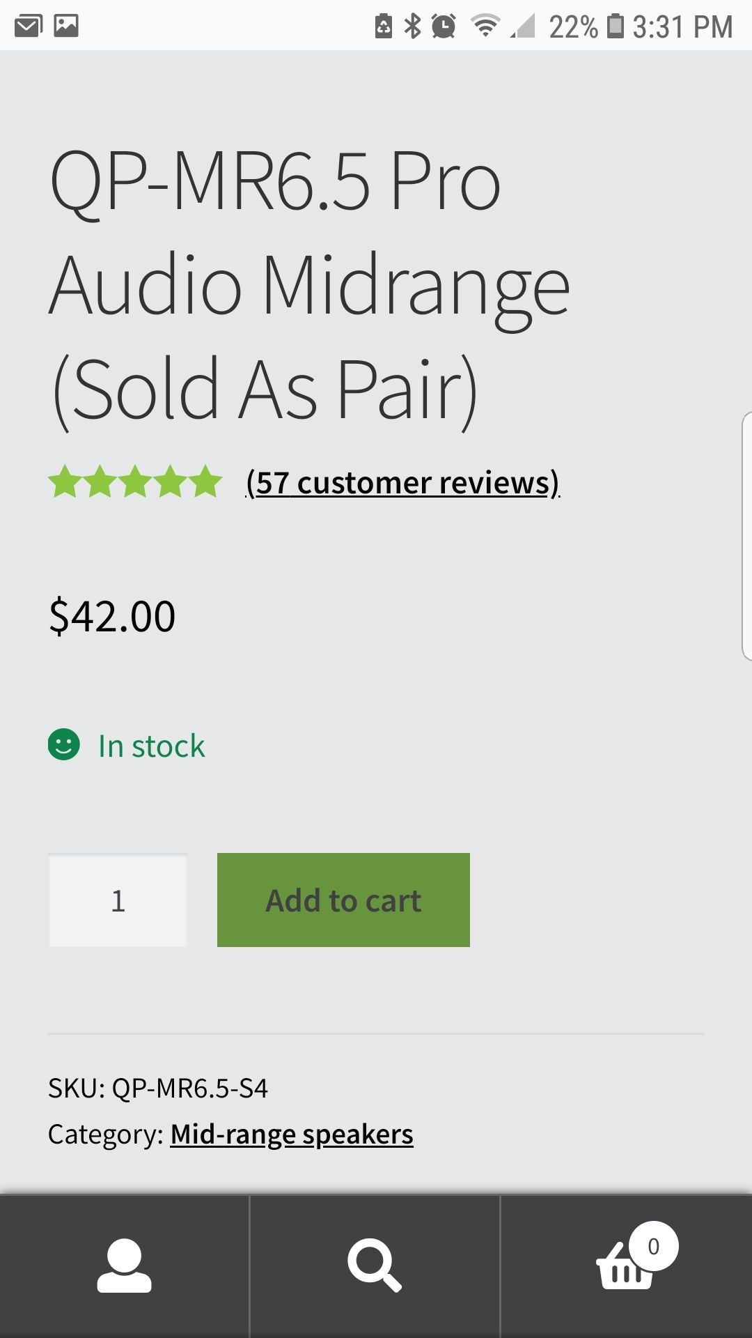

I would try these Soundqubed 6.5, they sound great ! As far as weather proofing ,all you need is some scotch guard from your local hardware store.

So, I got the Soundqubed pro audio 6.5" speakers for Christmas along with the speaker pods from Kerry's Cycle. I got the pods mounted without a problem and tried the speakers in the garage. I think they sounded horrible. Maybe I was expecting too much or had a setting wrong on the amp. I have the Soundstream amp on full pass. I ended up taking the Kappas from the tourpack and putting them in the lowers and they sounded better. Back to the drawing board. I'll keep the Kappas until I make decision on what I want to do.
