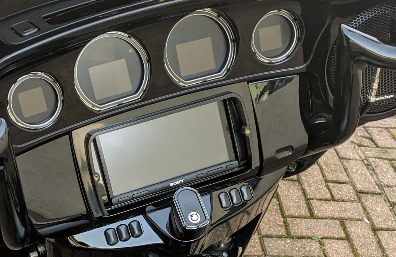

it’s only when you start investigating stuff you realise how bad fitting the Rushmore wings are. Not just that vent but either side of the screen there are big gaps for water. add British weather and you soon learn how wet it gets
the METRA modules take care of the wiring integration, and you can reprogram some of those functions but I’ve not fiddled much with those settings.
maybe ask Fat Head or other suppliers….better, find a forum member with similar year and Sony. They’ll put you straight
best upgrade I’ve done to my 2017 IMHO

wrap the unit in plastic draw-lining and waterproof tape and you'll have a waterproof setup. Thoroughly tested here in the on/off rains of England
Thumbs give you volume, source, forward / back, album skip, screen black out, attenuate
and those last two options are a massive plus over the 6.5 inFRUSTATION system my bike had
add to that you can use any up-to-date map source you want to use and that was my reason for switching.
I heavily researched the GTS, and after much sage advice that often focused on the waterproof plus, I'm kinda glad the MotoCo UK wouldn't sell us nor help us
retro-fit, as I now find the Sony interface more feature rich than what my buddy has on his GTS (and without the additional costs and faff of involving the dealer)

yep ROADIES, for when it pours hard (or if I set off in the rain). Carry it in a Nintendo Switch case in my bags
Pros: keeps the rain out. handy for dimming the screen at night in the dark (I have auto dim turned OFF for better day time viewing)
Cons:
ugly surround when its off the bike (more often than not). IMHO not so good at shielding from the pressure washer (even if I try not to aim direct). you can't touch screen (obviously)
