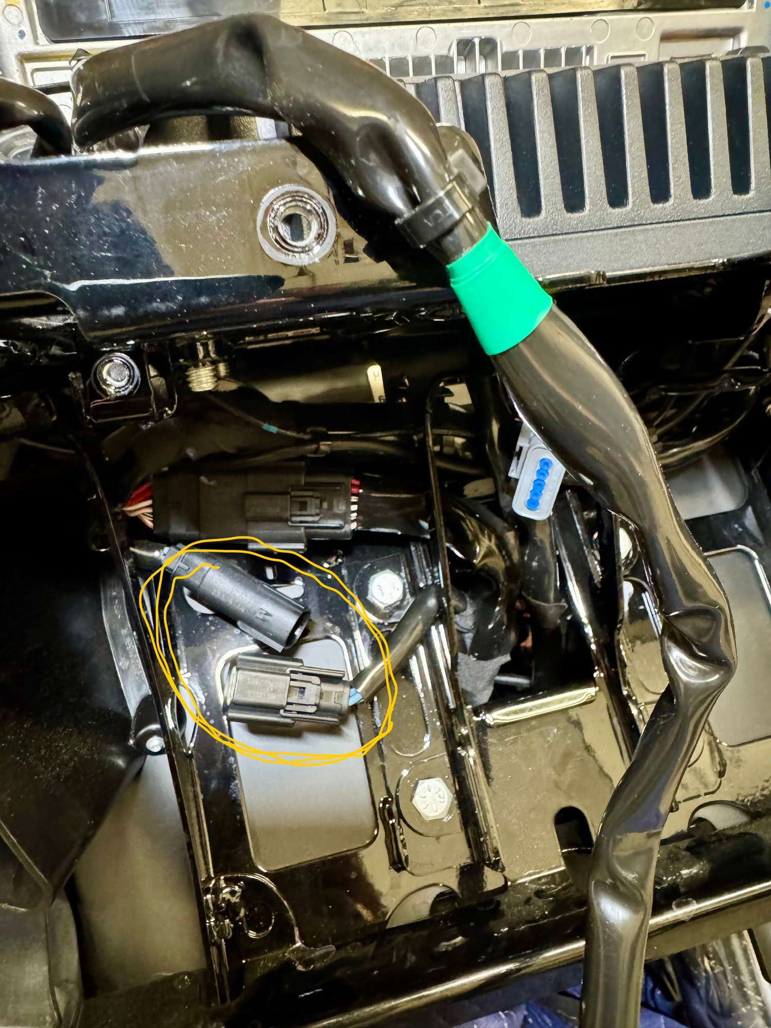

Hi folks;
i am installing lower fairing speakers (stage 3) on my 2024 road glide . I purchased the oem spekaer lower harness kit from Harley.
my motorcycle came with the upper fairing speakers originally..
i updated to the stage 3 upper fairing speakers, and stage 3 primary amp…
i was about to install the wiring for the stage 3 lower fairing speaker .

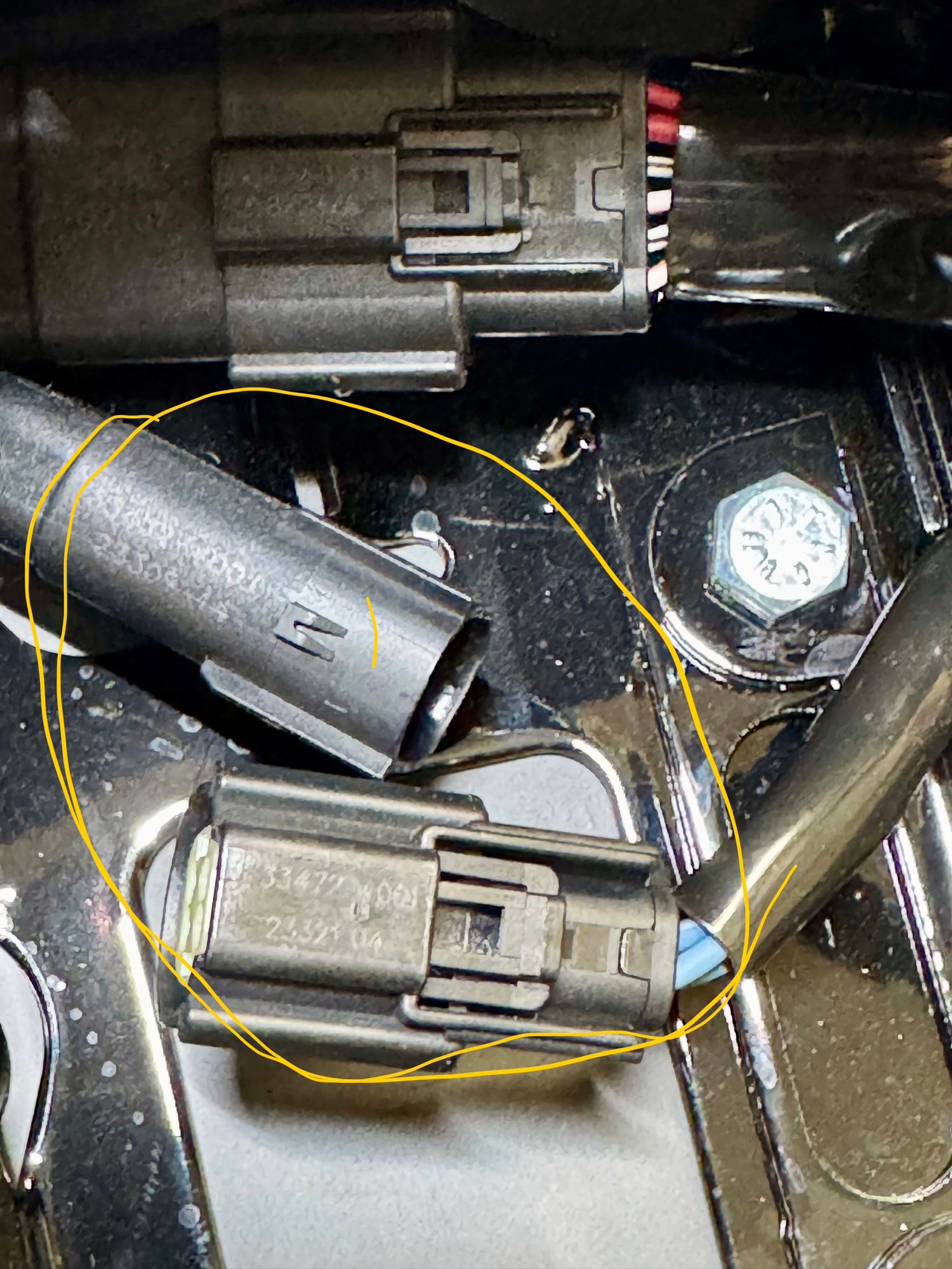

it appears the connector i need to use (4 light blue wires) is already connected , perhaps to rear speaker harness? I dint have rear speakers, so i i believe this harness is connected irregardless.
has anyone done the lower fairing speaker's and just the upper fairing speakers (making this just a 4 speaker setup)..
i disconnected the existing harness, that i think is just for rears, for future use.. and i believe i need to use that connector for the lowers
Am i correct to disconnect and use the 4 pin molex\deutsch connector?
if it is correct should i cap off the unused side (prevent water or moisture) just in case one day i decide to add another amp snd back speakers.
here are the pictures.the connector is circled yellow, and i disconnected them. I yave not connected the lower fairing y- connector yet
I also posted this in 2024, as suggested and pasted over here...sorry for the repost...

1) yes that molex connector circled yellow goes to the rear. On a stock 2024 road (skyline) glide with 2 speaker setup will have this “unused” molex\csble slready connected for a nicety. Future proofing.

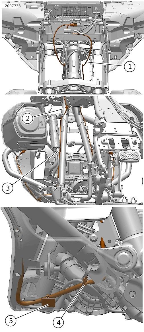

4) wiring through the nose along the frame L\R can be a challenege since existing wires are there. Be patient, its definitely possible. Remove any connectors rather than trying to squeeze them through.
