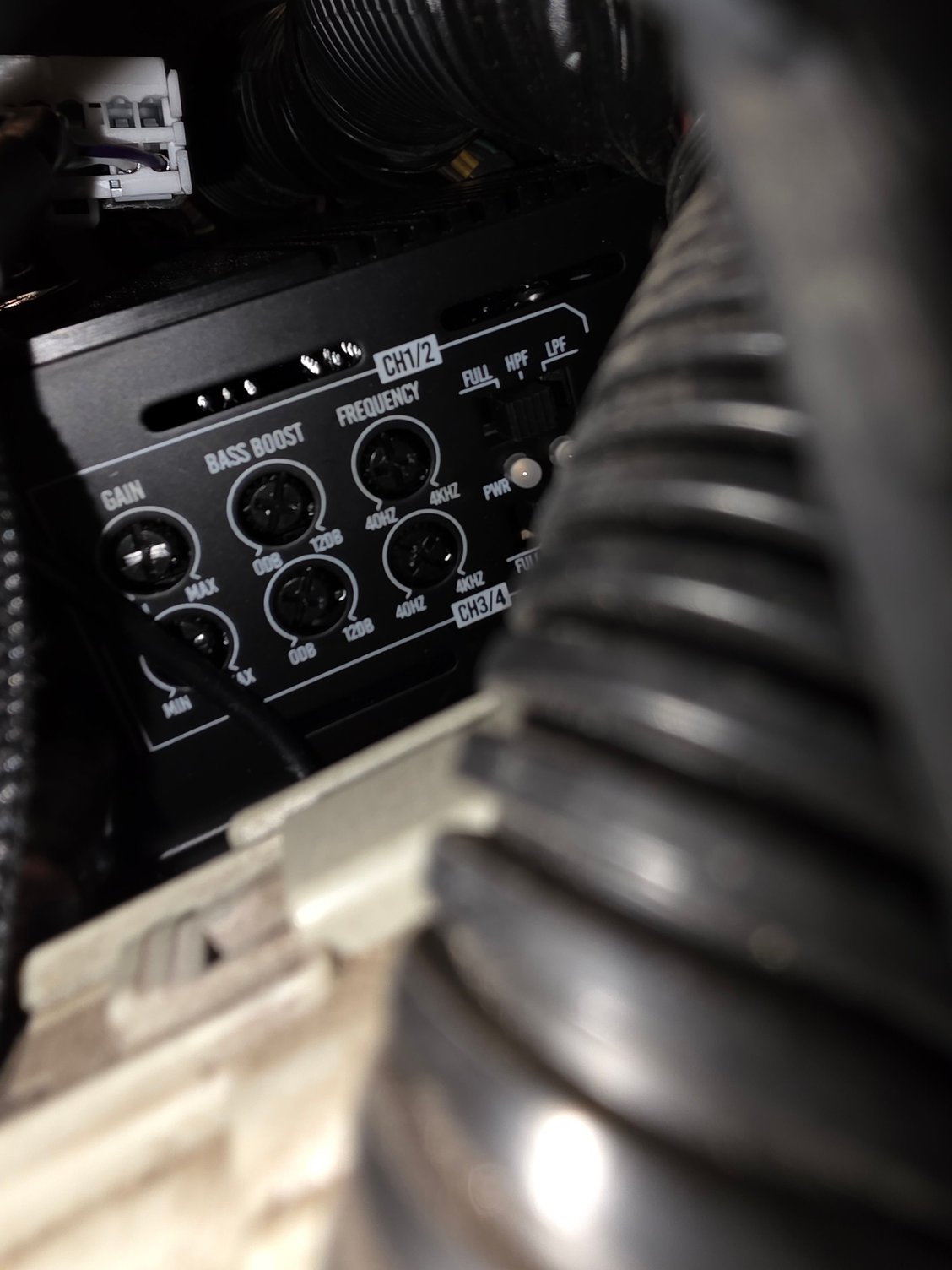

They are the coax speakers, with the ct-80.4d amp.
I totally understand that this level of bass gets lost at high speeds anyways, and so I'm ok with the bass being flat at super high volume. I just wish the bass could roll off automatically, or I could have a bass **** or something...I want to hear the bass at low speeds to some degree, and I don't want to mess with the whole eq every time I speed up and slow down.
CT sounds again heavily recommended leaving the pass on full with the meso coax, and just inching the gain down.

For starters on your settings are you contoling the crossovers (front and rear individual) thru the headunit??
If so start with the following set the 6.5s at 120hz and the 6x9 at 100 in headunit with amp crossovers set at full pass.
If setting crossovers on amp do the following.
Without having a CC-1to set the crossovers you will have to do it the old school way as below.
If you are relaying on the amp for crossovers your make sure the ALL sound manipulation is flat and off (EQ FLAT AND BASS BOOST OFF) then crossovers on amp set to HPF and turn the frequency setting to where you THINK the target crossovers would be.(as they are not marked very clearly)
Play music at higher levels and listen to speakers IF they sound distorted or muddy turn the frequency up if not turn down until they start sounding bad and then up just a bit.
Do this process with 1 set of speakers at a time (fronts OR rear)
Setting the xover on the amps this way will get you in the ballpark and keep the speakers closer to their safe zones and not play lower frequencies they were not intended to play.
This may take multiple adjustment to get it fine tuned to your liking. Set the EQ for your preference. If you raise the EQ slider up on the lower frequencies and there is no change you are above the crossover settings set on the amp and leave at 0.

I don't think I can set crossovers through the head unit, unless I'm not aware of that setting. I'll look. So you do think I should have the filter set differently for the 6x9s? Not the same for each set?
Only the low and high end are marked on the freq *****.
I'll check the head unit settings and keep tweaking the amp.
After I messed with it a little yesterday I took it out for a test run and I parked on the side of a deserted road. With the engine running I turned the volume up to like 35, and the weird thing is when I walked away from the bike and I was about 30 or 40 ft away it sounded great. It sounded just fine and it had plenty of bass. But when I got close to the bike and behind the fairing the sound quality wasn't as great. I'm not sure it's actually bass distortion at all it might be something in the highs. It's hard to explain, like it's too tinny or some of the highs are getting a little garbled together. But it only does that when I'm really close to the speakers.

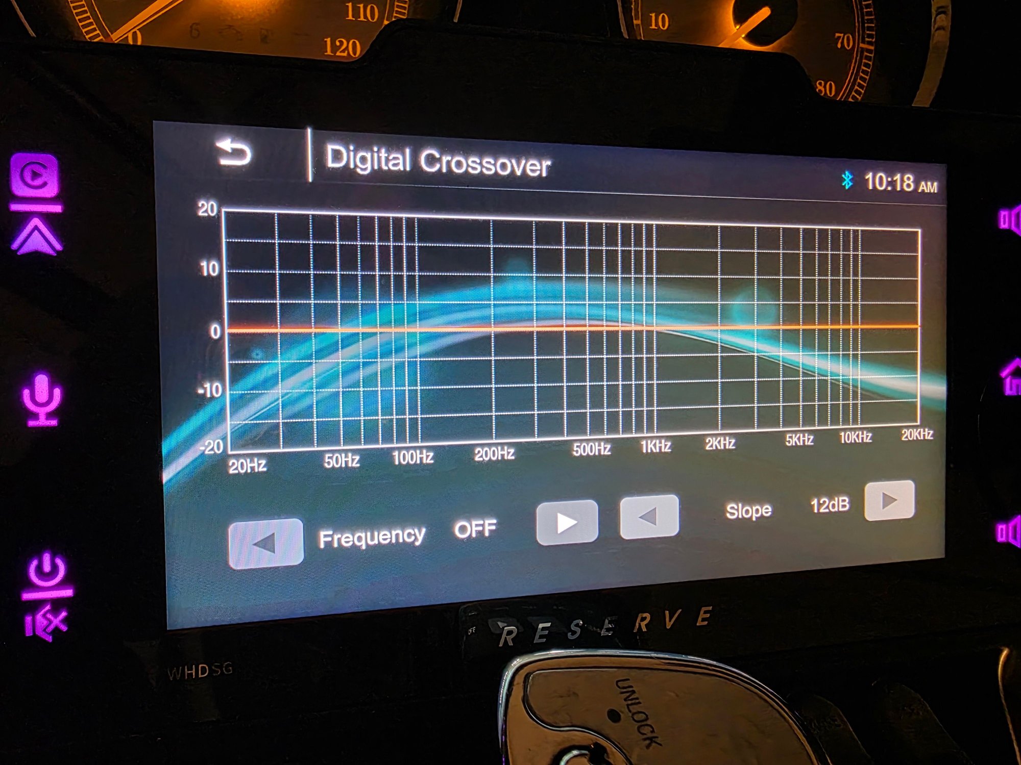

Head unit does have digital crossover settings. Looks like youd need a degree in something to be able to understand this.
Old Mar 10, 2026 | 05:21 PM
sdreeves's Avatar
sdreeves
Joined: Feb 2022
Posts: 95
Likes: 20
From: OR
Actually this one was really basic. Only a few frequencies to choose from, and either 12 or 24db curve. Can't even set different for front and rear. But at least it's there so I just set it to 80.
