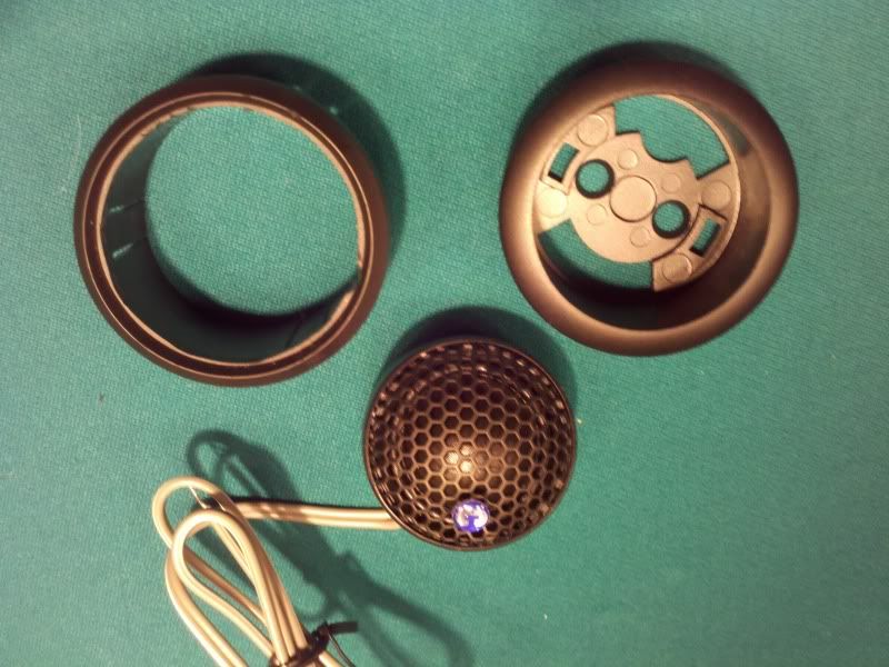

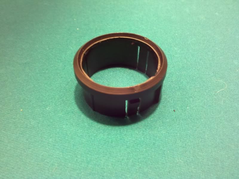

Here's a cheaper way to do this... I putting a Ultra faring on my Road King with 6.5 component speakers, this is how I set up the tweeters.
Purchase Harley's gauge plugs:
Drill holes around the inside of the face, using nippers nip between holes, then use razor knife and trim so that tweeter bezel fits in hole.
Epoxy the bezel into the gauge hole and insert tweeter
