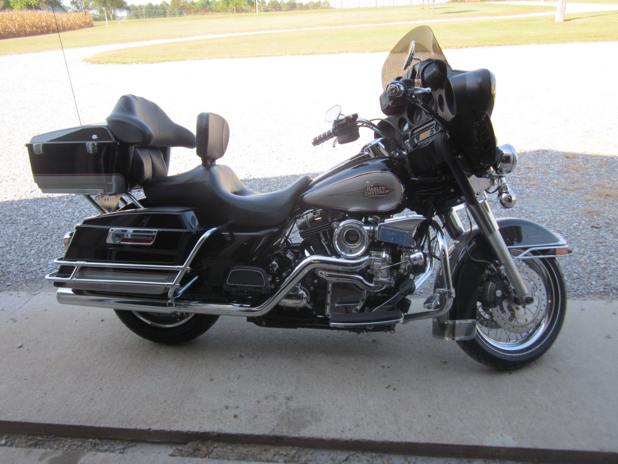

Not mine but I saw this at a local show

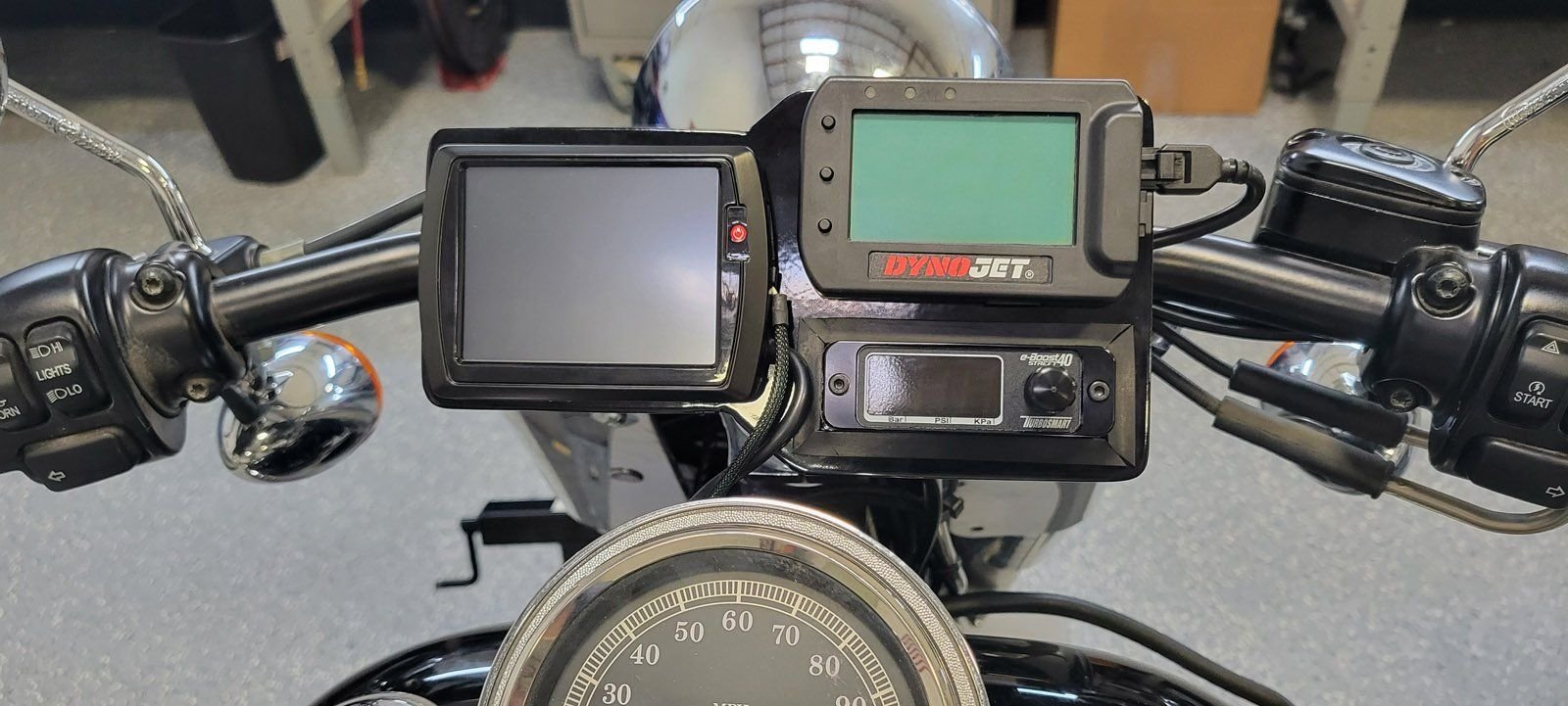

I'm sure the manual controller will work well. I opted for the electronic because I wanted the ability to have precise control at the different levels of boost. Here's how I mounted mine up with the Power Vision and POD-300 display for widebands. It's made from 1/8" T-6061 aluminum sheet, then black powdercoated, and attached to the bars with two Power Vision mounts.
