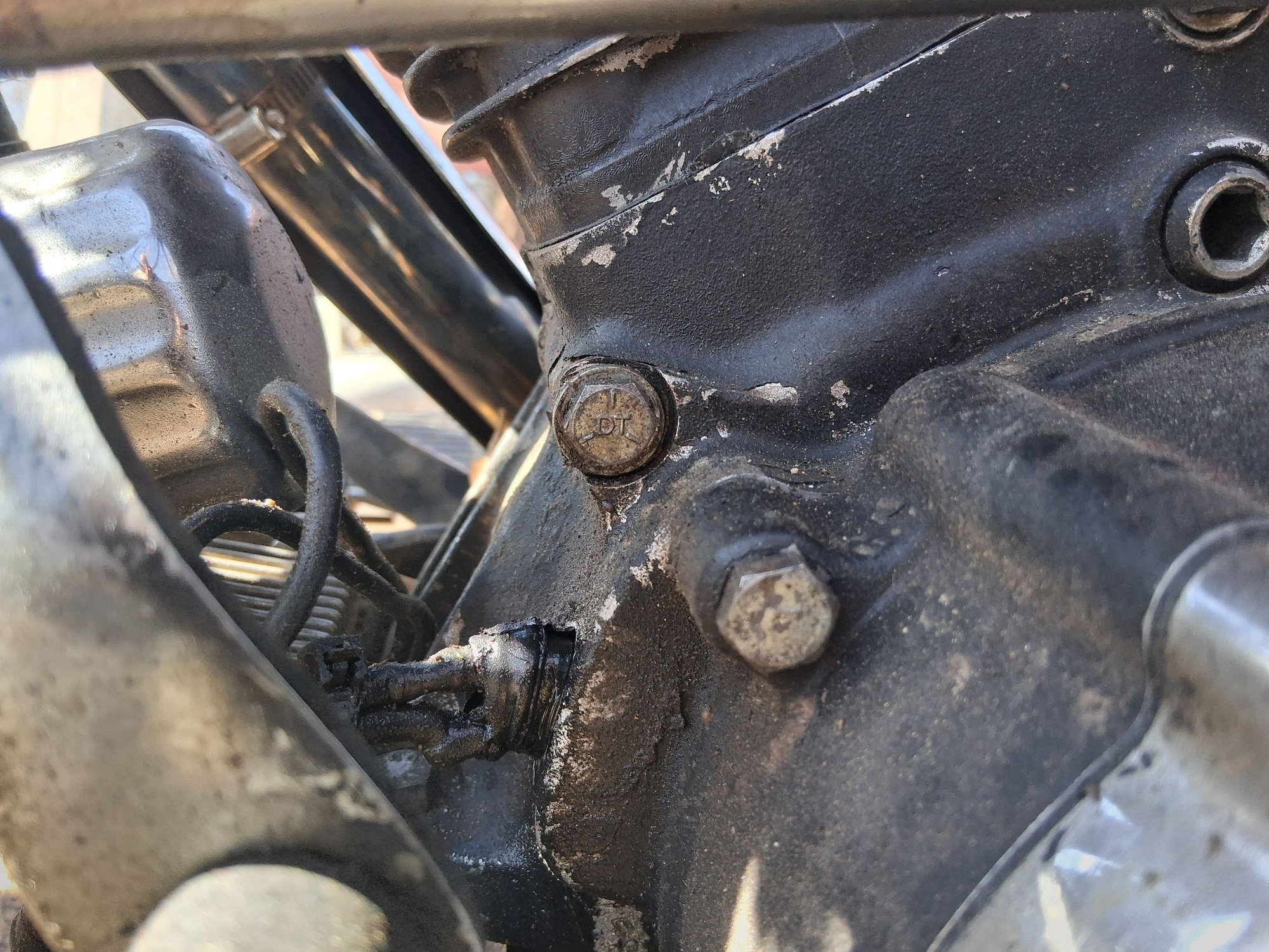

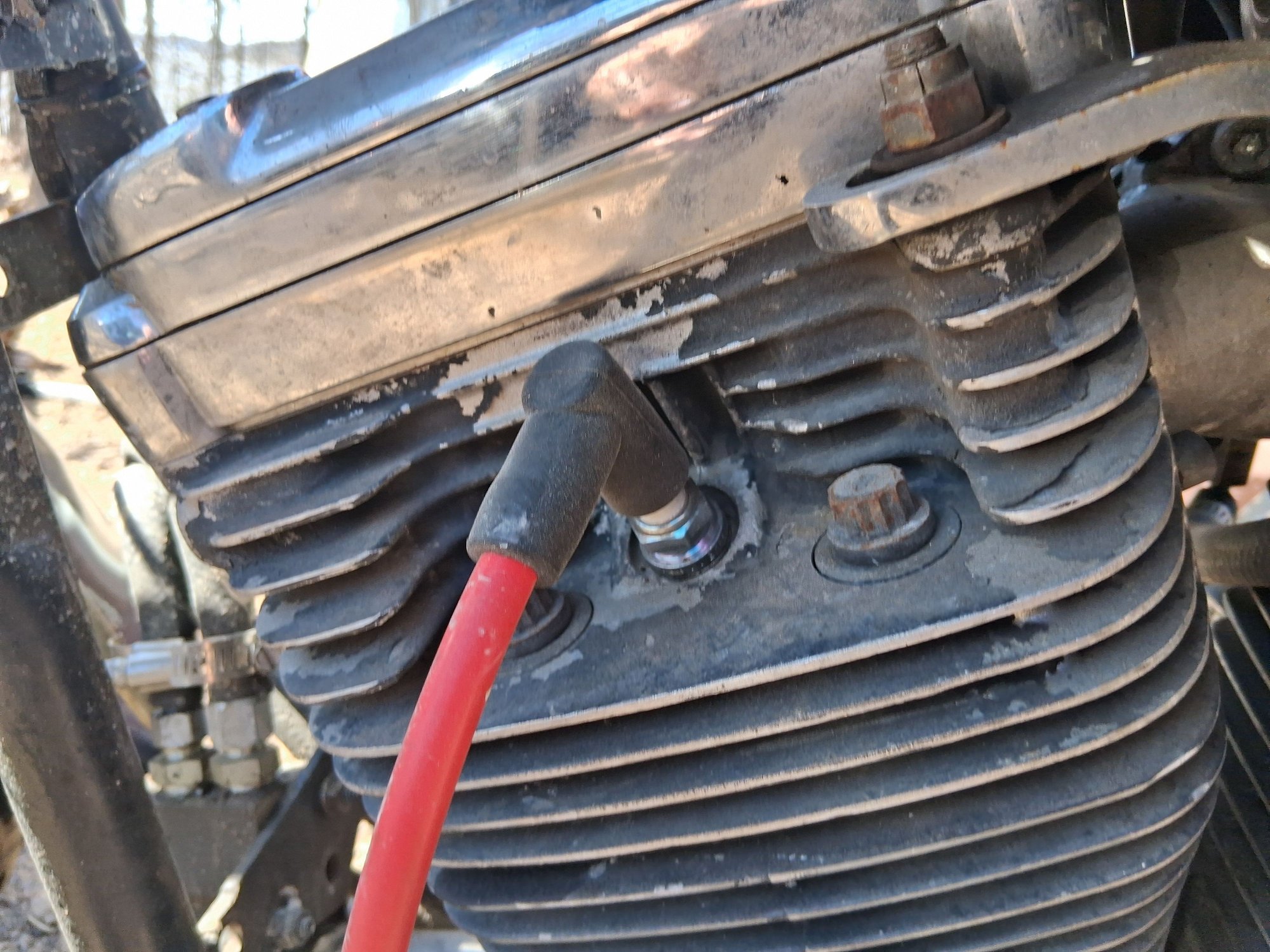

Thanks for the photos. What is this marking? It could be the start of a crankcase production number (CPN)? Are the first two characters 1 and 5? If so, 15 is one of the code numbers used for CPNs on Evos.
Third character may be 8? Whatever it is, it and the fourth character may indicate model year of the crankcase. In total there may be ten characters. (R-H case may have the same CPN but it will be inside the gear compartment near the cam bearing and therefore not visible on an assembled engine.)
Also on the left case have a very close look at this area. Do I see any markings here? Or has anything been removed? Or maybe it’s just the photo? It may be a good idea to clean this area thoroughly to be certain.
Regarding the number you found on the R-H side of the front cylinder, it may be 16584-83 or 16584-83A? Or something else? There may also be some other markings nearby, including the H-D trademark. Rear cylinder may have markings in the same area?
Eric
theses are on the left side down near the stator plug
Eric
These numbers are down near the stator plug on the left side
Old Mar 25, 2026 | 11:55 PM
Speeding Big Twin's Avatar
Speeding Big Twin
Joined: Feb 2009
Posts: 691
Likes: 390
From: Western Australia
Thanks for the photo. As I suggested in my previous post the first two characters are 1 and 5. And 15 is one of the code numbers used for CPNs on H-D Evos.
Next two characters (86) indicate the left case is a 1986 model.
Next three characters represent the day of production and the last three characters indicate the production number for that day.
Your CPN appears consistent with factory stamping for a 1986 model and here’s a partial example for comparison of most characters.
But what about the area I highlighted with a blue rectangle in my previous post? Did you check that area thoroughly?
