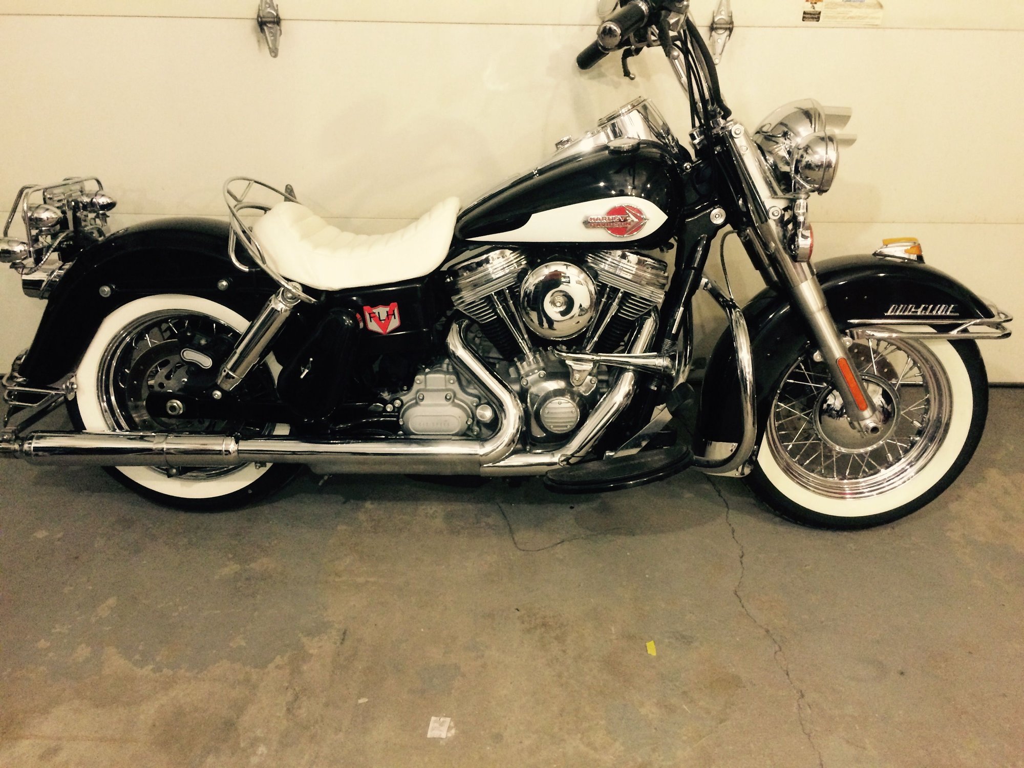

First decide if you want the HydraGlide style front end that was used by FLs from 1948-59 or the nacelle type used from 1960-84. The HydraGlide is what the current FL Softail is styled after. These parts are readily available as new take offs. The 60-84 style would require an aftermarket triple tree and nacelle (or old eBay ones but usually lots of $$). They would both use the same 41mm forks and either Softail sliders and fender or modern FLH sliders and fender.
This is just the start so look around the old interwebs and decide which style you like first.
Here is my 2008 Street Bob with HydraGlide style front end
