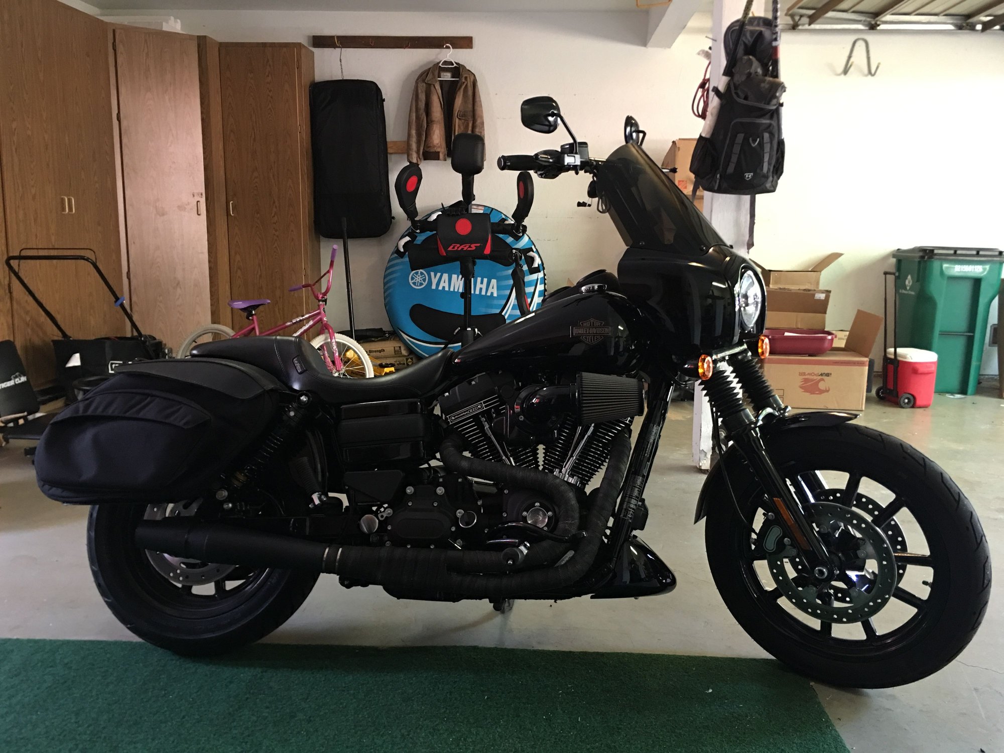

This is my 2017 FXDLS. I swapped the entire stock tree out for an FXDB triple tree for the same reasons you are wanting. As far as I know, you would need to do the entire tree for correct fork alignment.
