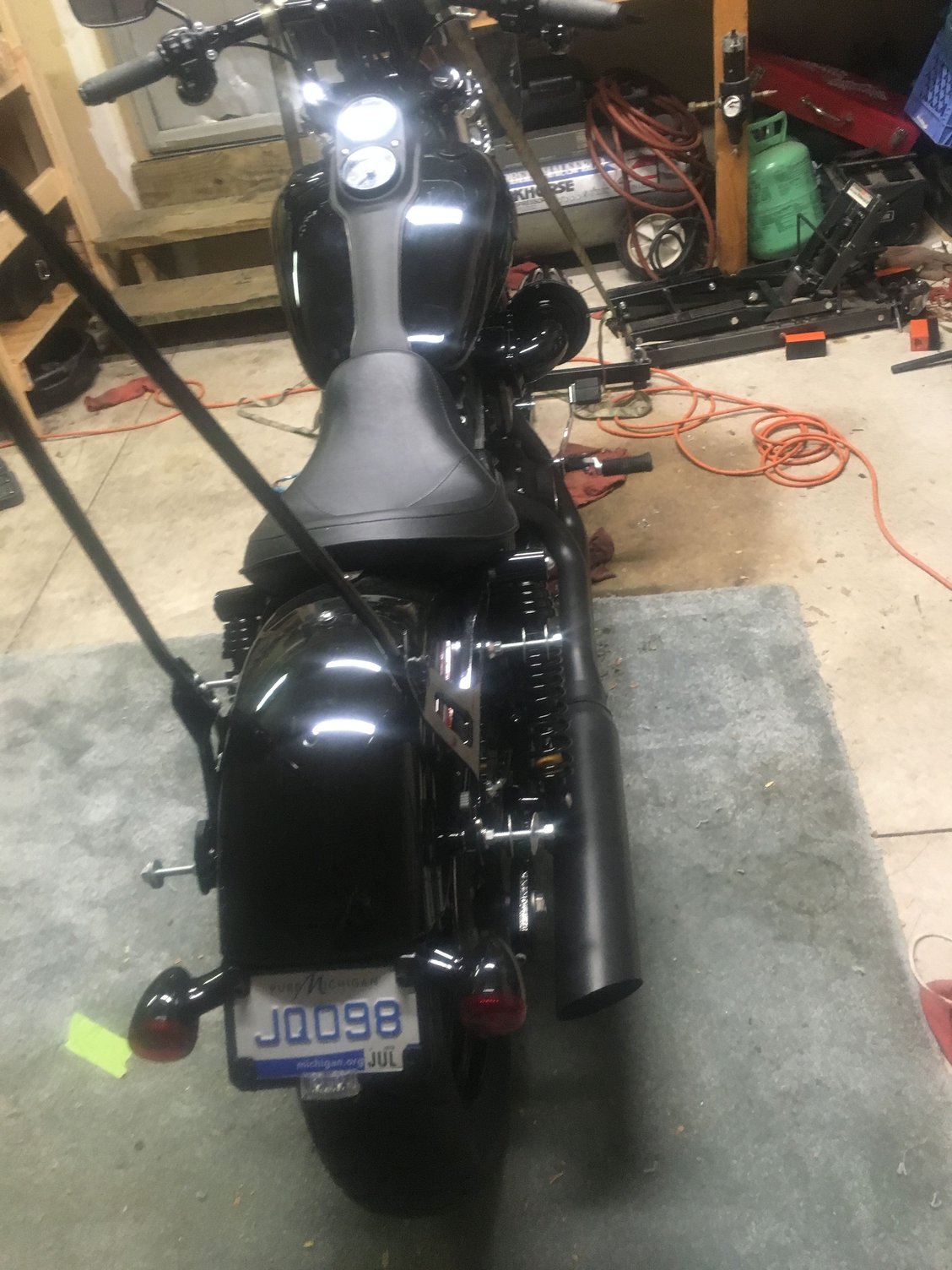

Have you seen the great bike gear signal/plate relocation kit? Only asking cause I was the same way but needed to be able to have bags for trips, and found this kit. It's quite popular and I love the look of it cause it keeps the signals the same.
Sorry for the shitty pic, I got rear ended last week so I won't be taking any new ones until I fix it.

Heres a a couple better shots of the kit. I was so happy when I found this kit cause it let me keep the signals exactly how I wanted. Still miss the side mount plate but what can you do.
