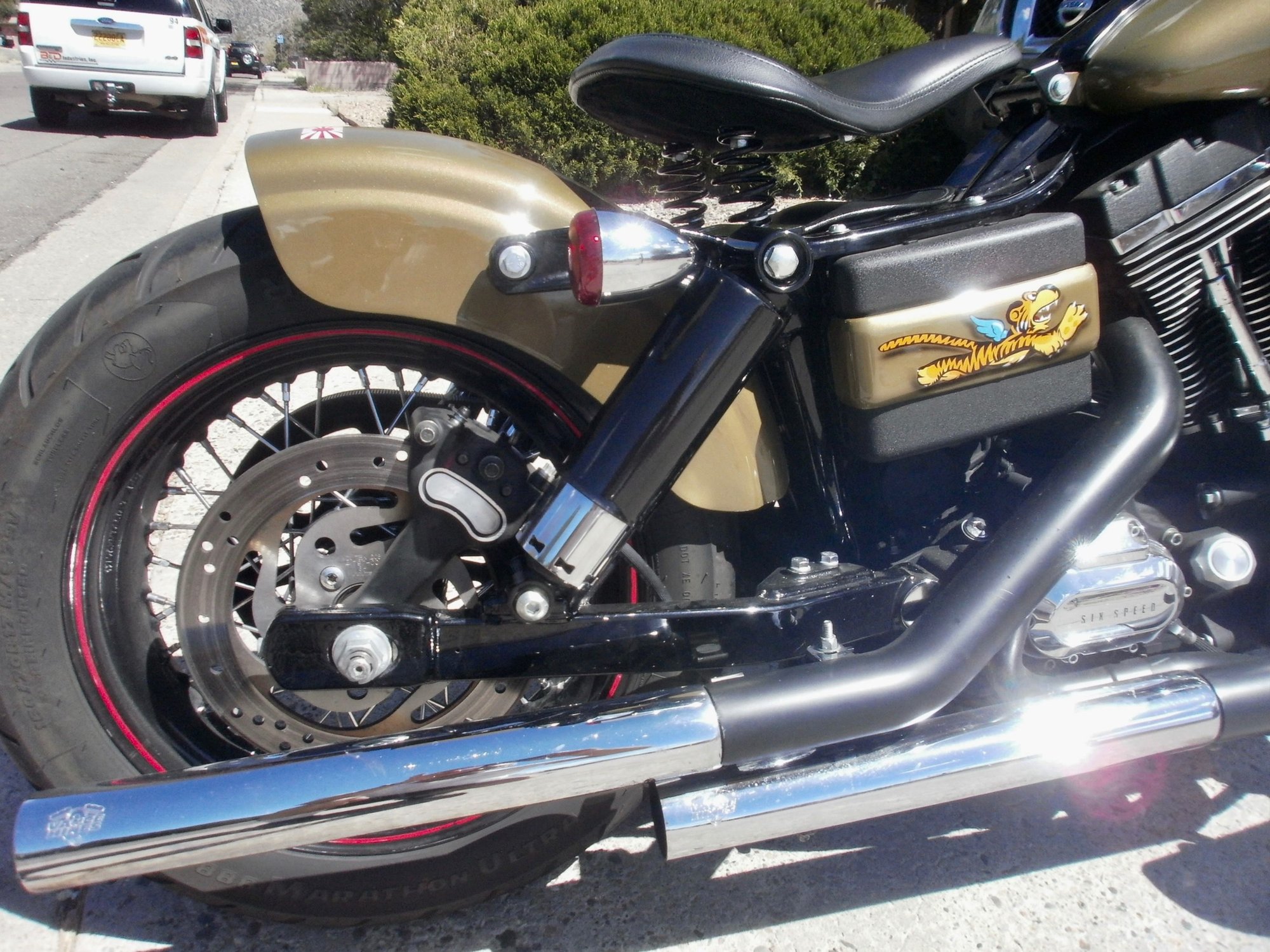

I chopped the struts right behind the stock forward holes, the ones where your turn signals are now mounted. Before I chopped I removed one shock absorber and then compressed the remaining shock all the way using a ratcheting tie down looped around the swingarm and the strut. I laid some 3/8" rope over the top of the tire and laid the fender on that, and then marked where the new mounting holes would go in the fender. That way I new I could bottom out the shocks and the fender still wouldn't rub on the tire.
I also rigged up a front mount with some bar stock that let me solidly bolt the front of the fender. I'll see if I can get a pic of that but it's pretty hidden.
As far as the sharp edge, I sanded mine so it wasn't quite so knife edge-like. Seems to work OK.
Finally, I drilled some new holes in the struts a little forward of the fender mount holes to move the turn signals a little farther forward.
Mounting the fender lower took away most of the "dirt bike" look, and when I'm sitting on it the shock compression lowers it even more.
