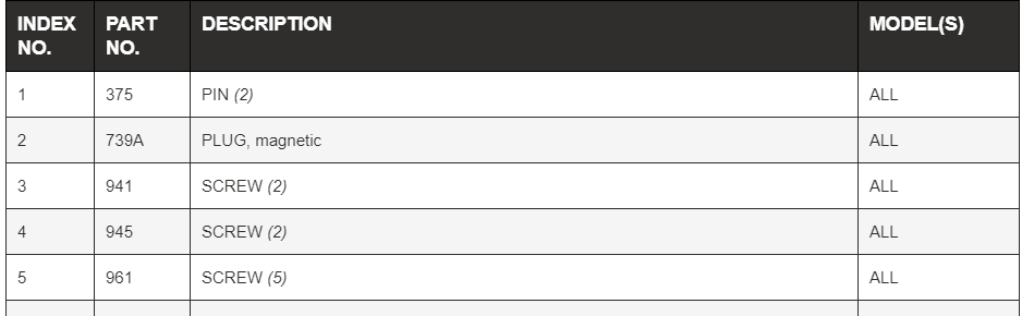

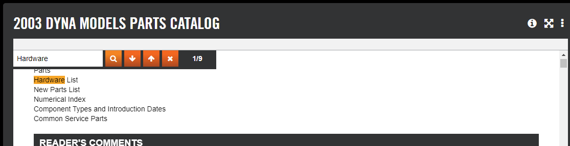

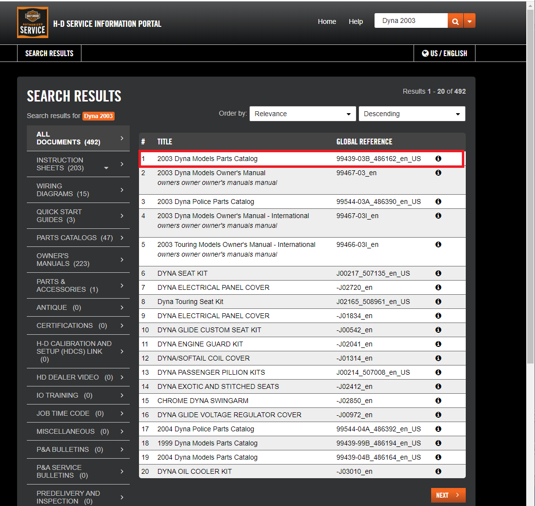

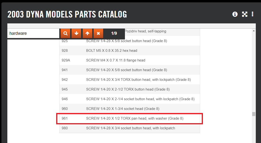

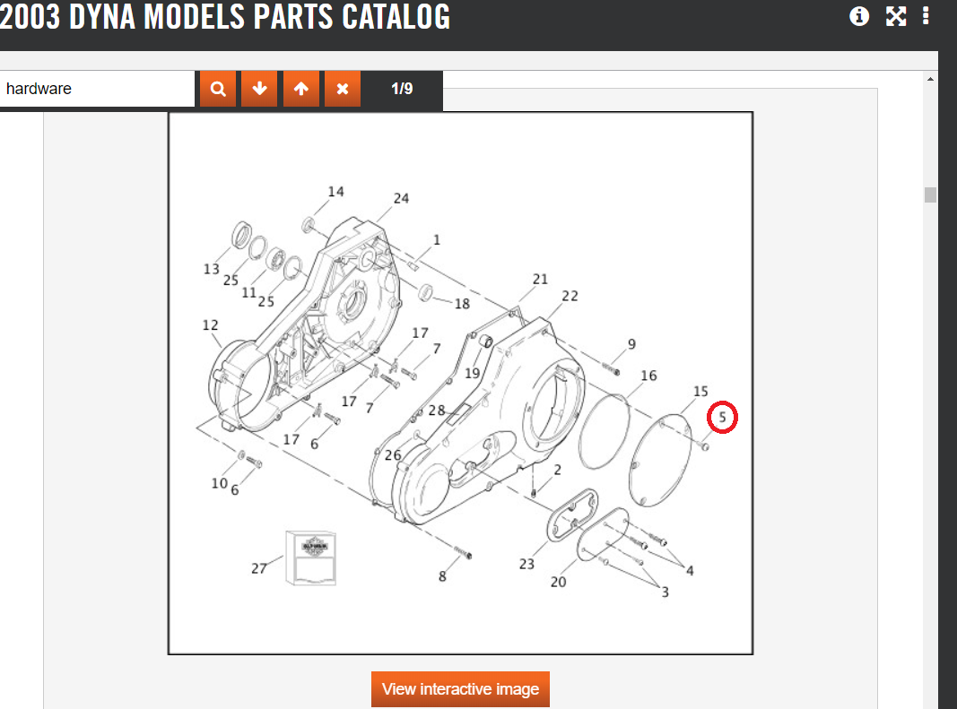

Go to Harley's SERVICE INFORMATION PORTAL
Type your model name in the top right hand corner in the "Search" box and click the seach button
Find the desired parts catalog and open it by left clicking
Find your p/n in the parts diagrams
Type "Hardware" in the search box and the site shows you the link to the hardware list
Click Hardware list and look up the p/n's specs
If the p/n is not in the list, search Google for harley-davidson+p/n+specs
