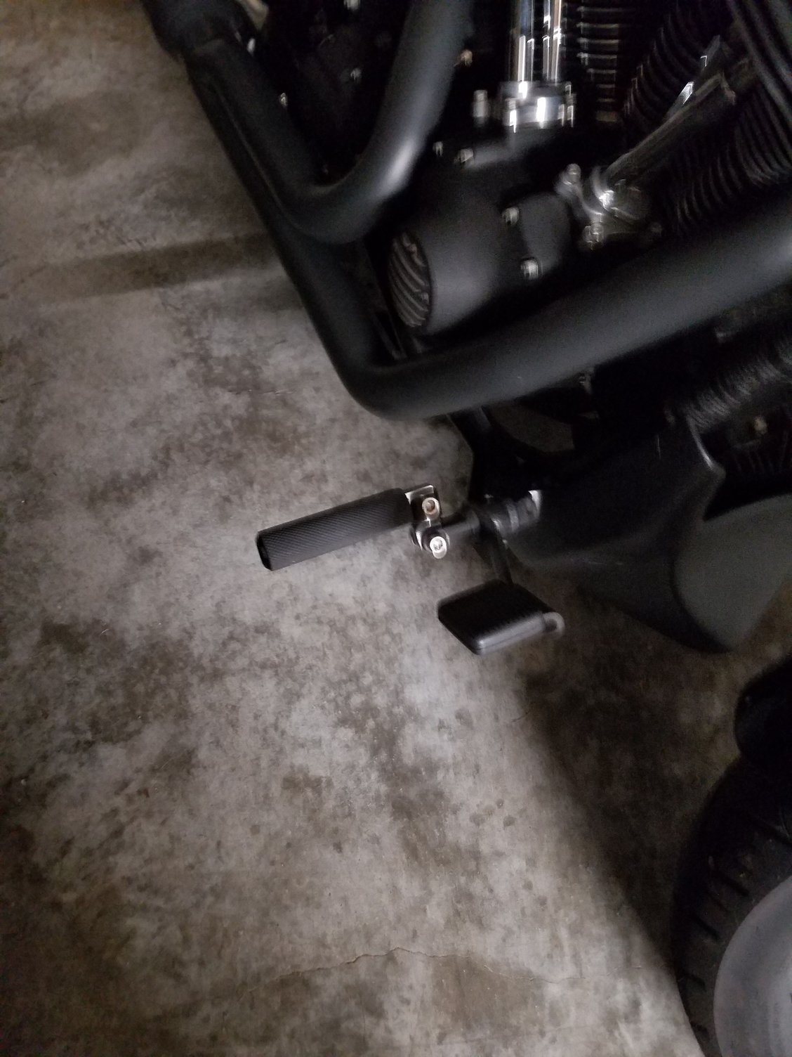

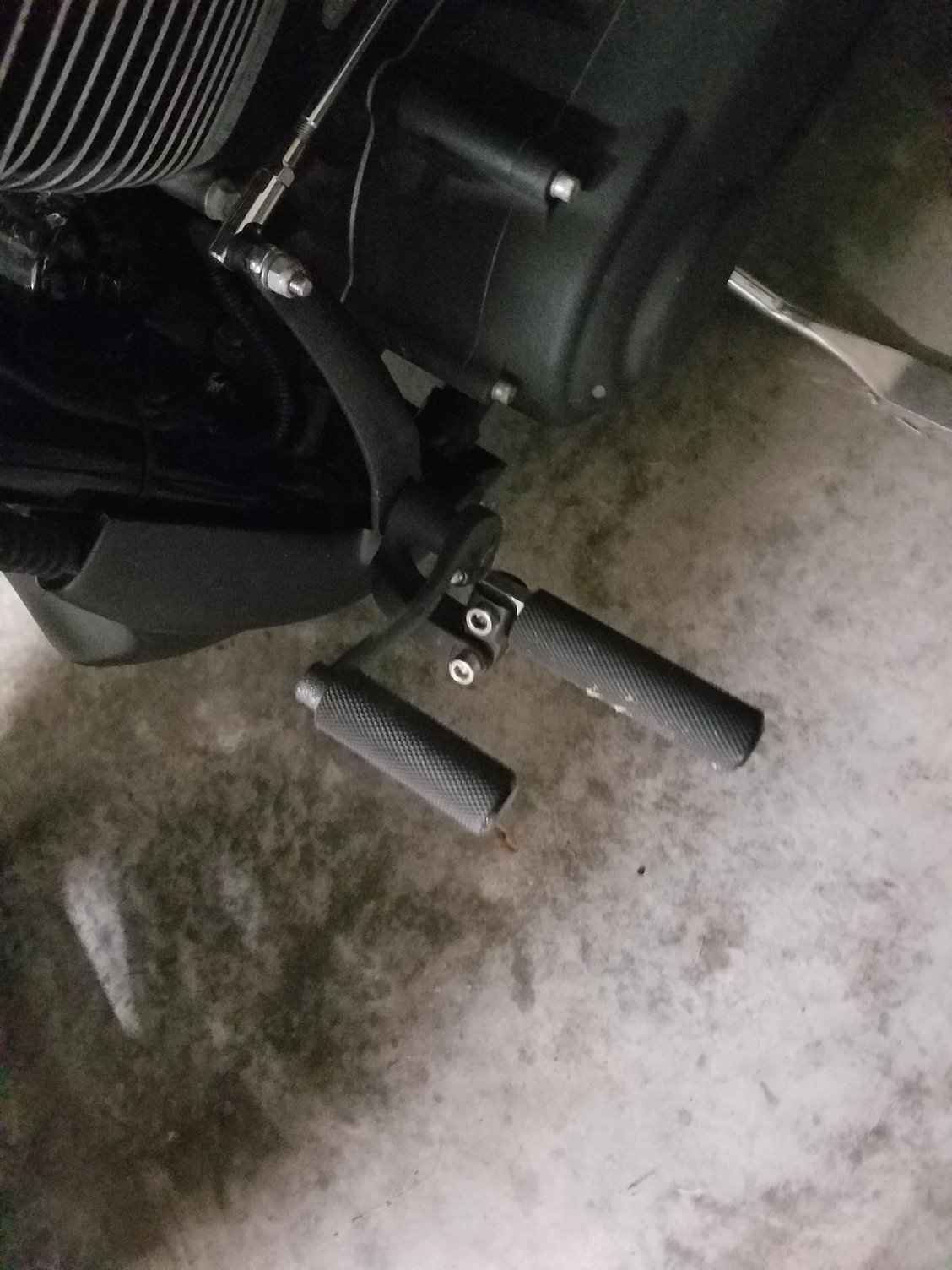

I bought some Kuryakan peg extensions and ground off the bumpers.
Flipped sides, and rattle canned them black, I think they are an inch and a half, brought my feet closer.
