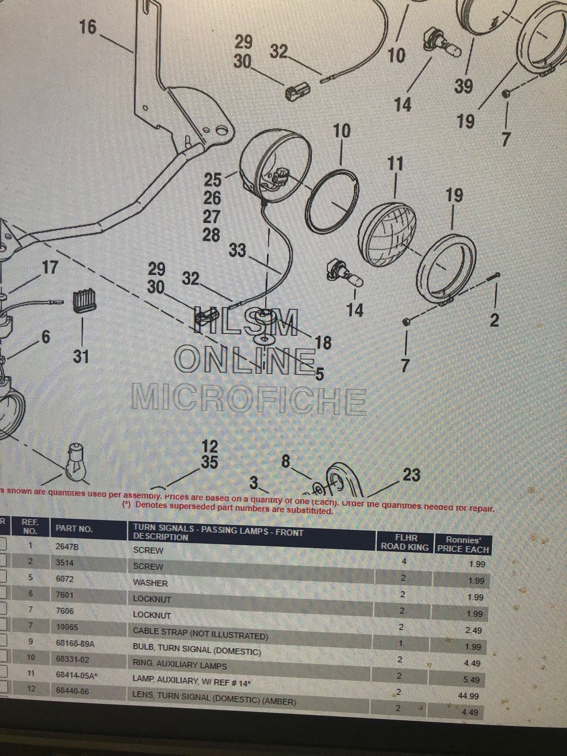

88, I think those Bulb housings with replaceable bulbs (as you show above) have the Later lens/reflectors which don't have the "Classic" look he's after

B
Yes, but it's much closer than the Daymaker styles. I think that's just what I'm looking for.
