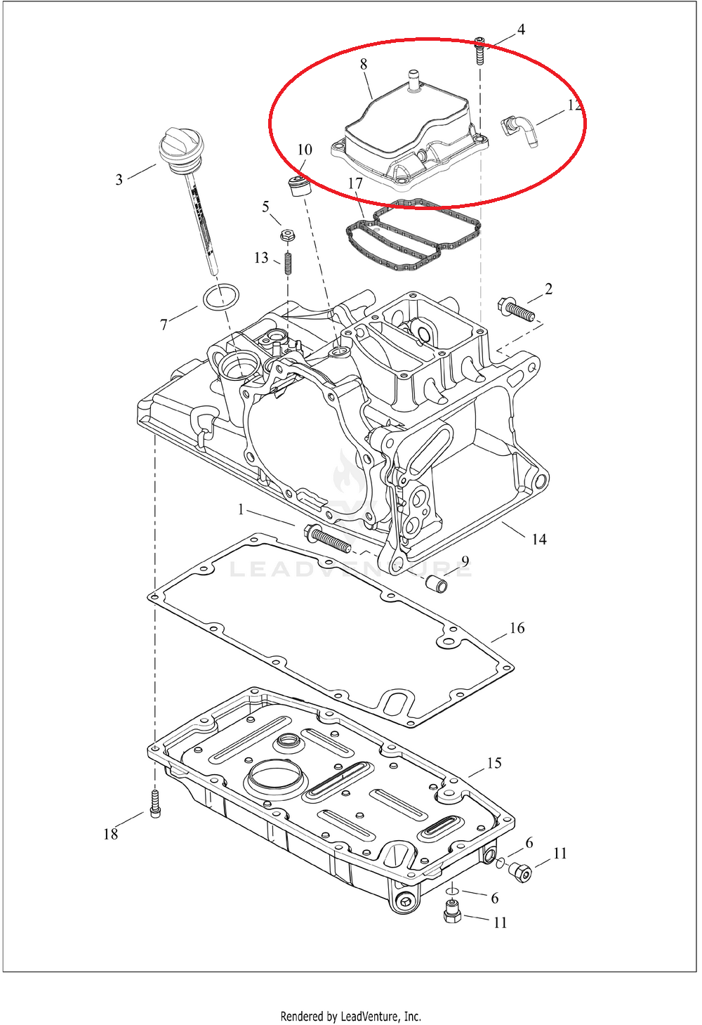

Forgot to mention this particular piece is from NICECNC.
What is the cost? I think the newer harley covers are less than $100, they also have 4 screws instead of six which is no issue as I installed one on my 2019 Tri Glide.
Ref:8
29400448
VALVE,ENGN BRTHR,COVER ASSY | top, with 34800071 and 34800043 (black)
Price: $88.03

No need for any aftermarket breather kits any longer.
Just buy the latest transmission cover for the m8, part number 29400448, and run the hose overboard, no filter or catch can.
The cover is $88.
Replace the oem breather bolts with solid bolts.
