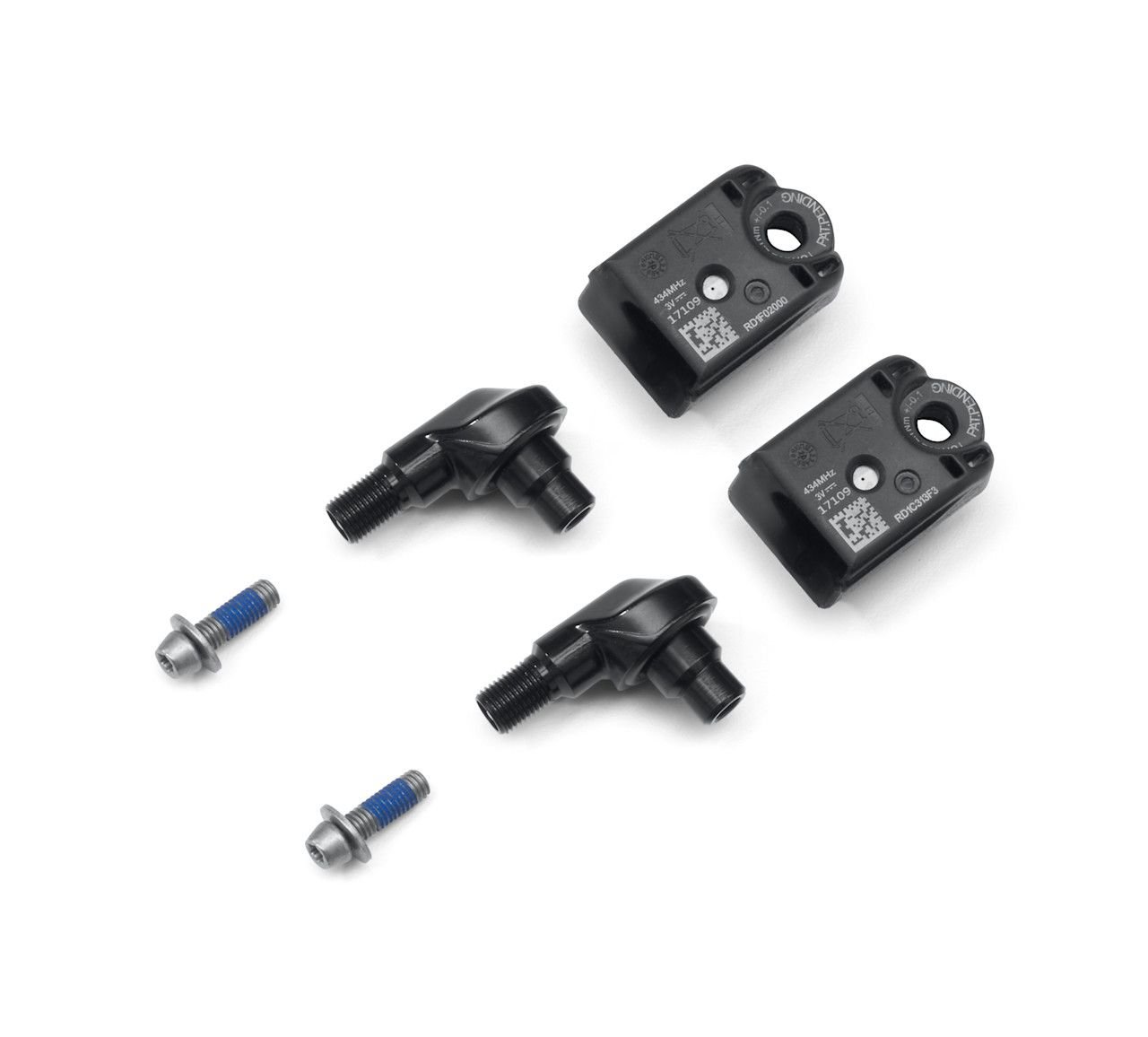

And they are usually buried in epoxy, so there is no such thing as changing that battery, you have to change the unit itself.
And seeing they're 10 years old, change the front while you're at it.
They look like this......
