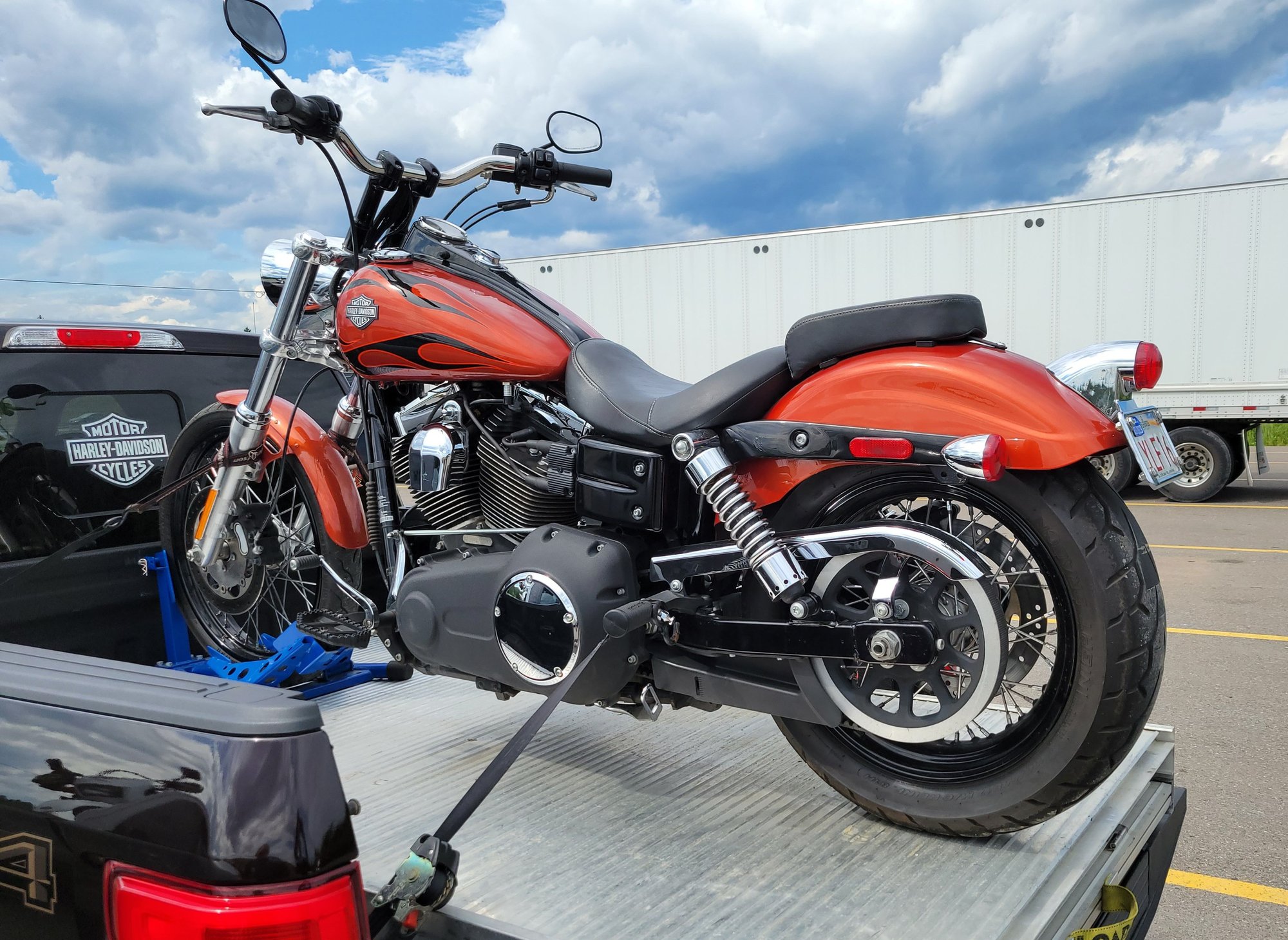

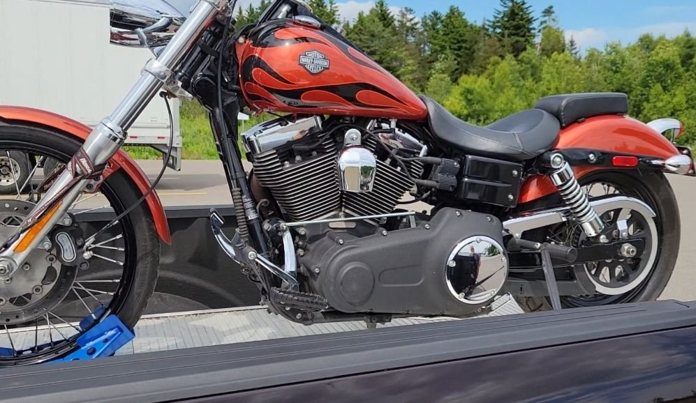

Hi everyone
new fourm member and also new WG owner. 🙂
Just bought my first Harley and although i love the long front end i would prefer a fatter wheel / tire setup.
so looking for advice from the folks in the know :--)
Thank you
Derrick

Upon rereading my post I realize I was not very clear. Its a 2011 WG and its the front tire wheel combo that I want to be a little more meatier :--)
