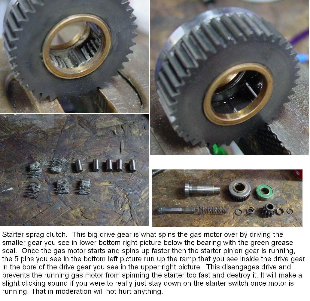

The starter clutch is actually a sprag clutch. Its clutch mechanism is several roll pins against a solid shoulder. It works and can only slip if you hold the starter engaged once the gas motor starts.
Then the gas motor spins the big ring gear and the small starter gear faster than the starter motor is turning, and that action runs these drive pins up a ramp, and it disengages them from the shoulder, and the little gear just spins.

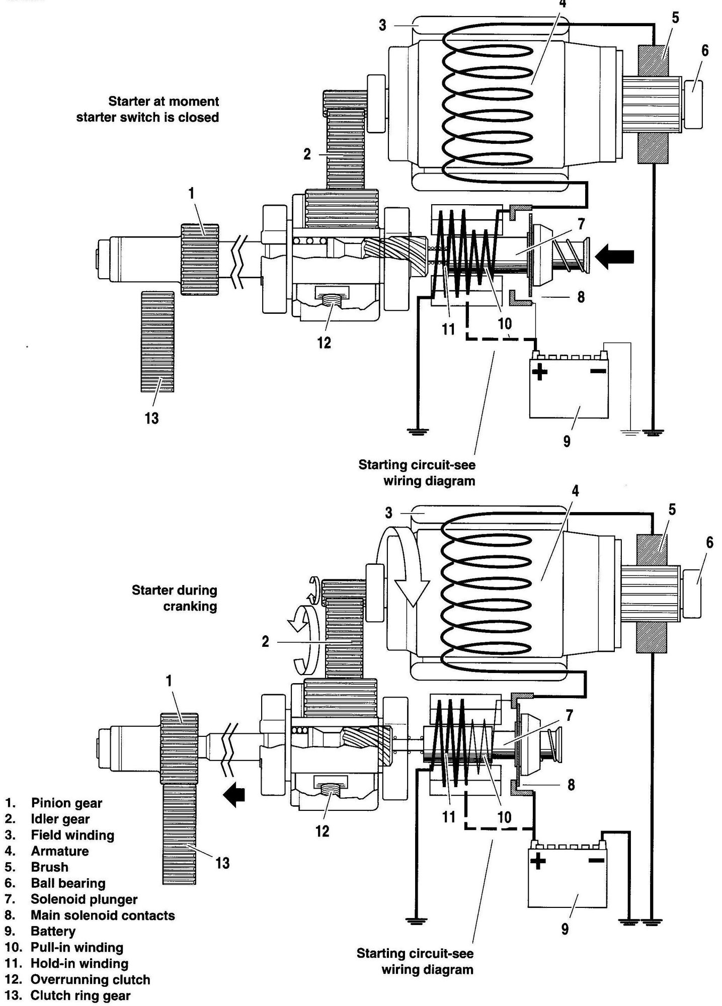

Posts: 20,836
Likes: 12,330
Your issue may just be the solenoid plunger not pushing the gear into the big ring gear.
No.
If the solenoid plunger does not push the pinion gear into the ring gear, the starter motor will not get power.
The plunger pushes the pinion gear into the ring gear, when it has pushed it all the way the electrical contact in the solenoid will be made, allowing power to go to the motor.

Posts: 38,078
Likes: 6,237
Actually the starter can run without pushing the gear into the ring gear. It not directly connected since it's driven fwd by the small coil spring between it and the solenoid.
I addressed what I said since first poster ask. However the majority of it delt with GM car starters and the feed back from what people on here gave with the same issue that fixed the problem.
And it sure wasn't the sprag clutch.
However for sure replacing it doesn't hurt and helps the aftermarket economy.
If you replace it, be sure grease is not all caked up behind it. One I rebuild, I did it a second time with high speed ball bearing grease. I used a black moly grease first time. It dried up and caked it up again.
My original post suggests the basics. And sure it can be the sprag clutch jammed up . And if you do the basics first and then get into primarily, you will see it fully engaged and free wheeling.
This one appears to be something other then sprag clutch.
