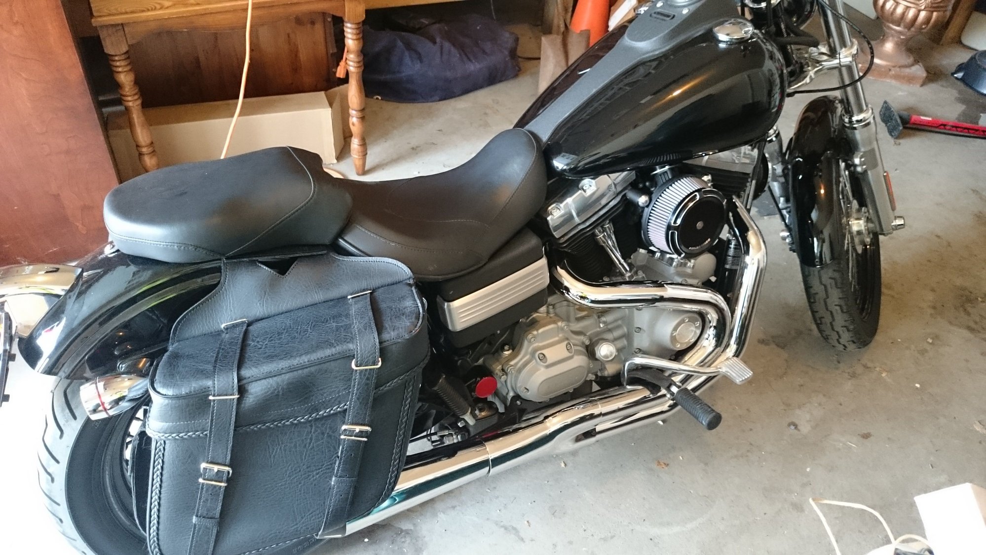

Having a similar issue can't tell if these bags are even on right
Im pretty sure these are way too big can anyone let me know

I've always wondered about this with "throwover" bags. Thought you had to have brackets or whatever installed for them to attach to and lay against. But you can just let them rest against the shocks???

In all honesty most Dyna saddlebags are slanted as to sit behind the shocks, or have a cutout to go around the shocks like the Harley oem saddlebags for Dyna, pics attached are my ride with my daily bags from Bad&G and you can see they are slanted behind the shocks, your actual saddlebags will be fine, but tie them tight to the support brackets so they do not get pushed back in the wind, and brake off your blinkers, ps Left side is old and right side I got a month ago, this is why one is more used than the other.
