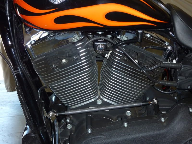

Thanks 883Iron. Here is what it looks like today; Last pic is with horn relocated.
