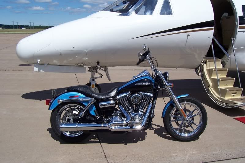

brand new to this site, Im doing this same swap to my 07 superglide custom, you guys got any pictures of the finished product?
Here ya go! I personally don't care for them. I'm switching em to 5.5" pullback risers w/LowRider bars.
