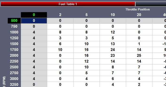

Seems like mine my bike runs a bit warm. I have the PC III USB on a 2004. How much would I want to add to Throttle Positions 2 and 5 / RPMs 750 to 1250 to cool it. Or what should I do?
How do you cut down on decel popping? I added 4 to the zero position for 1000 - 3000 to try and cut down on decel popping but I think that made it worse

i'm not sure if it may help or not due to a different year/setup, but when i called fuel moto(bought from them) about the decel pop that i was getting, they told me to start with 15 in the 0 column from 1750 all the way to 5000. they also said to increase by 5 until the poping reduces/stops, with it possibly maxing out at 50. i ended up adjusting mine to 20 and popping is all but gone. I would classify it as being gone, but someone with a super critical ear might say it's barely there. as far as the heat issue, i'm not sure what to tell you as mine does not run hot...sorry.
