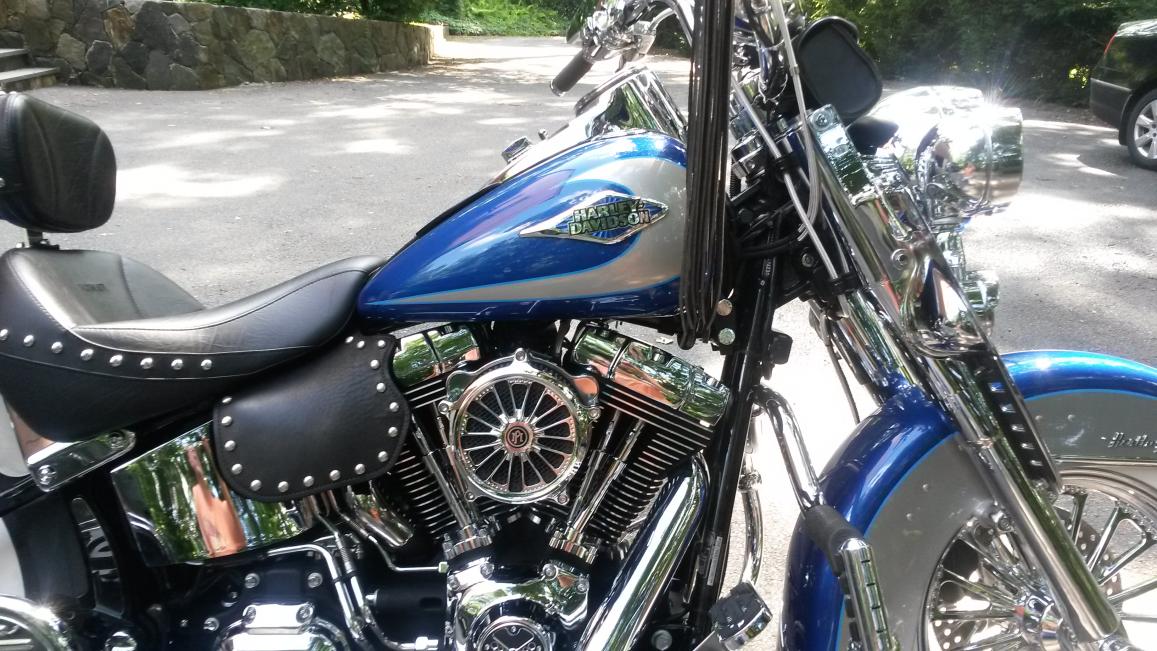

I just did both of mine with 1.5" in the front & 3/8" back. Looks great & definitely cools more. I used a DK on the FXST & a Dead Creek kit on the Heritage. Neither required fuel line extensions, only the vent line. I like both kits but each had it's drawbacks & positives. It was tough to get to the nuts behind the tank ears on the DK kit. The Dead Creek had a little to much material left after the bottom hole. Looks like it was the same size for a 2" kit. I added some nice chrome covers on the nuts for the Dead Creek & it looks much better. Here are some no so great cell pics.
