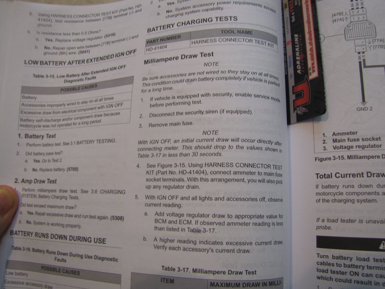

If you have a volt meter with a min/max function you could hook it up to a fully charged battery and start the bike. Shut off the bike and check to see how low the battery went while cranking. I believe 9.6 v is the magic number, below that is bad.
Does this happen often? Only when parked for a few days? Keeping it hooked to a tender will help.
Here are a couple pages from the electrical diagnostic manual:
Good Luck

Thanks Vernal. I have tested the voltage upon starting bike with charged battery and it drops to 8.8 volts. Yet the battery tested good at the Harley dealer. Even though the stock Harley battery says it has 405 CCA, it only tested at 366 CCA at 12.4 volts. But maybe that's normal for a 1 yr and 9 month old battery? I also think the battery load tester the dealer uses will state the battery is OK if it tests over 50%. Here is a link to the HD battery tester the dealer uses. It's on page 3.
http://charleybragg.com/Linked%20Fil...ical_Forum.pdf
Also thanks for the ETM pages. I'm going to have to pick up a copy of the ETM.
