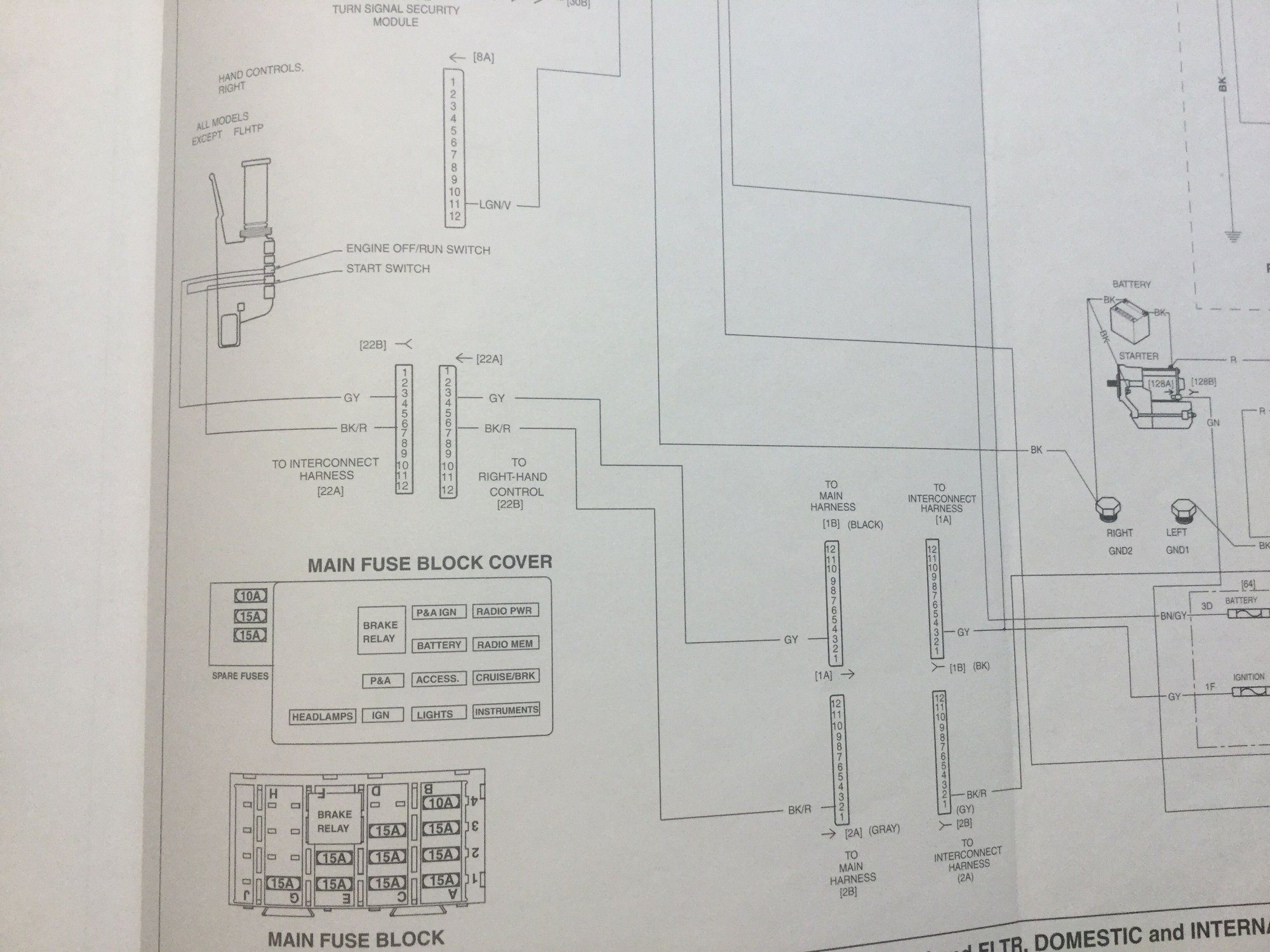

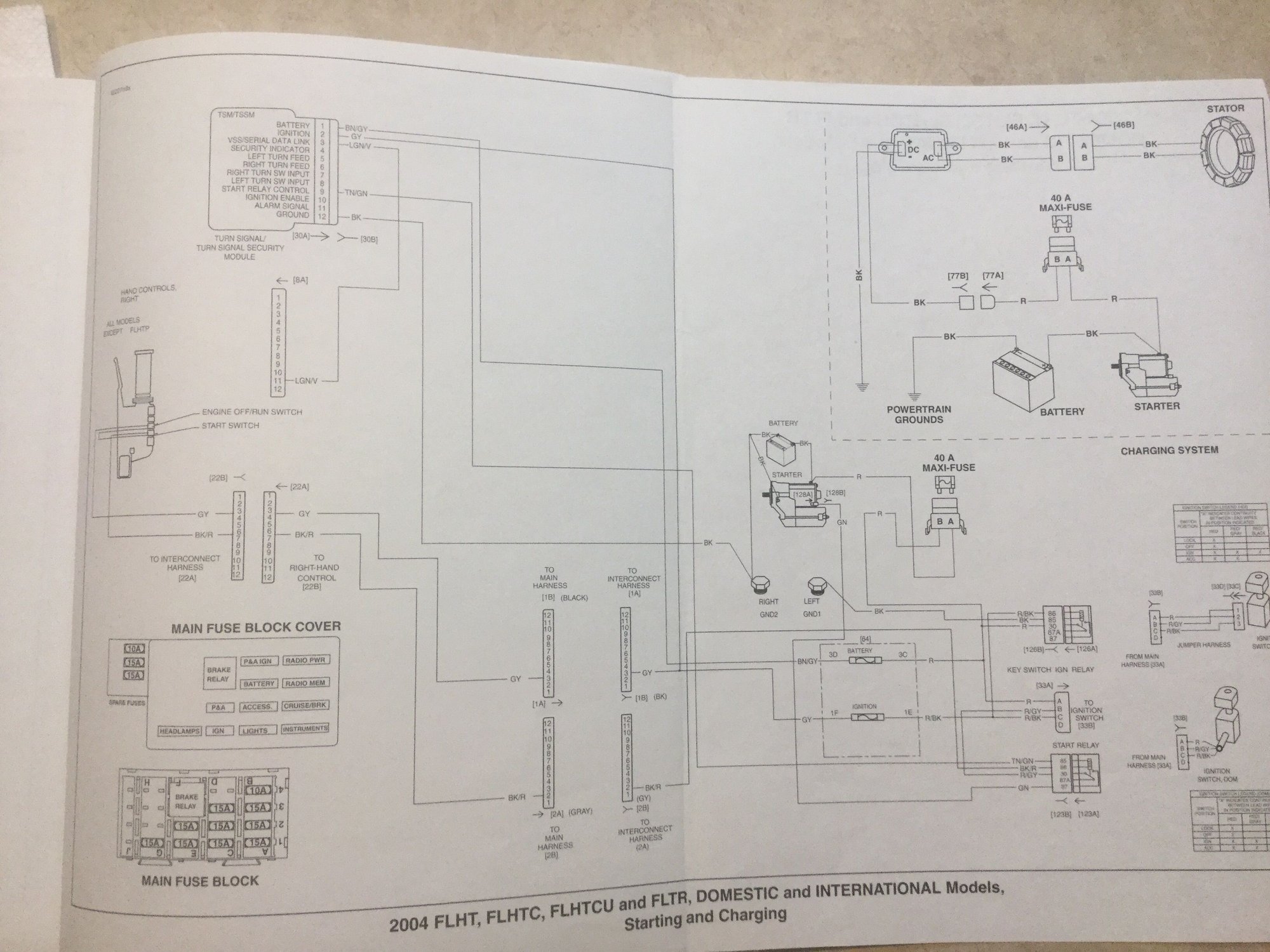

Old Oct 2, 2016 | 08:22 PM
Vernal's Avatar
Vernal
Joined: Apr 2013
Posts: 7,674
Likes: 8,397
From: Utah
The pages are from a 2004 touring manual, don't know if they would be the same as your bike but you get the idea. This link will let you look at the parts and see how the switches on the bars are laid out and the wiring harness.
