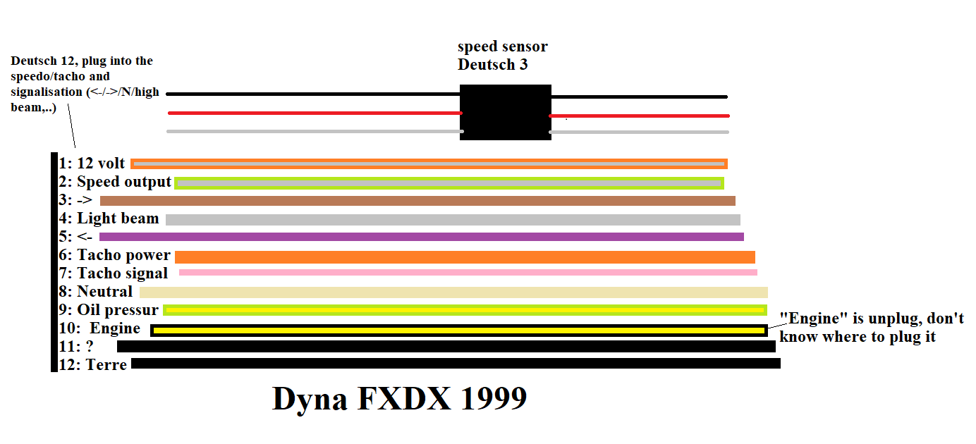

My name is Bob, I live in Switzerland, in the countryside of Fribourg in a farm. I recently buy an FXDX from 1999 and I have a *** problem to replug the stock speedo and tachometer, and maybe one of you can help me.
This is what I have on my Dyna. The previous owner plug an MMB tacho, where the red, white and black wires arrives. Now, i've replug the stock tacho and speedo like the wiring diagram says. The tacho works, the speedo is on but the needles don't move. This is logical because the speed sensor is not plug anywhere. The problem is, stock it's an Deutsch 12, but I have now 15 wires and I have absolutely no idea where to plug it. Does anyone has a clue?
Thank you so much and greetings from Switzerand!

No need help anymore.
If someone is one day with the same problem, the wires from the speedo sensor goes DIRECTLY inside the speedometer.
