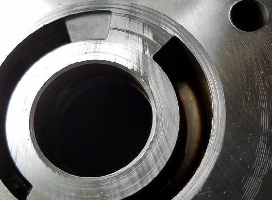

The whole point of me going into the bike in the first place was a low oil pressure problem when the bike was hot. was reading 2-4psi at idle while hot when i believe its supposed to be 5-8. Normal idea being that the dude that did the cam swap didnt align the oil pump. Hense why im here.
Im not liking what im seeing. Was hoping i could get some opinions on what i got here.

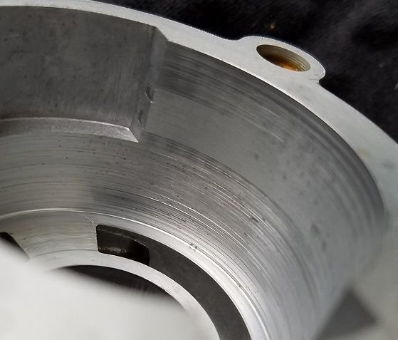

the back of the plate where the oil pump mounts to
oil pump inner wall

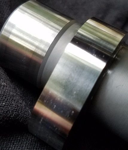

Cams seem ok, no discoloration, some very slight pitting though.

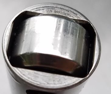

Not liking these lifters though, thats whats concerning me. thats not flaking and is smooth but still.

Pictures can be deceiving but the pump, plate and lifters look like they should be replaced; runout will tell more. 2-4pis vs 5-8 is actual vs spec via a gauge that could be off a bit and measuring at idle is not be best check of oil pressure. Check pressure at cruise rpms.

Check the run-out. Stone the cam plate and pump, I'd replace the llifters and polish the cam with some 320-400 grit.. Lifter looks like 99C,,
BTW, the oil pump on my 02 RK looked about the same.. 60,000 miles ago.. Still 15 psi hot idle and 35 psi at 3000.

We see a fair amount of pumps come thru with wear.
Not uncommon.
That Drag "Daytona" pump, does work well.
