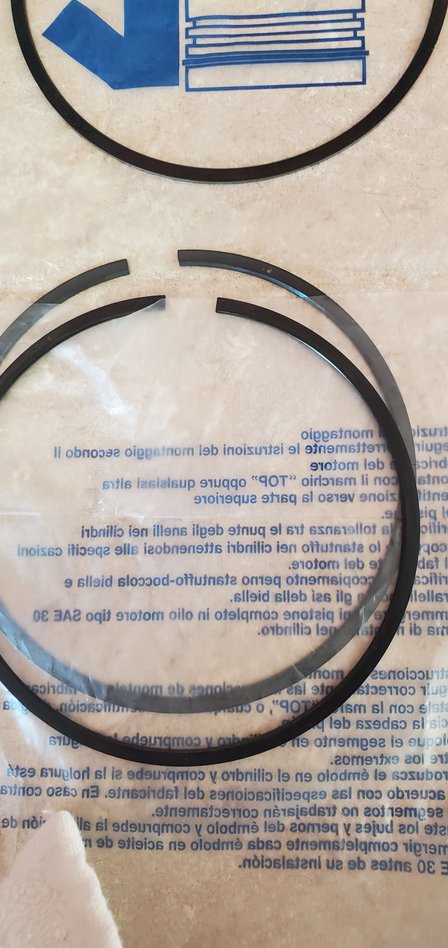

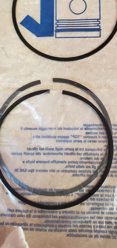

In look at the Hastings rings they are same in size as OEM, but different in design. First off, top ring non-direction as no "dimple" and no taper.
Second ring is tapered and beveled like oem. Third oil rings are the same.
Any thoughts in #1 ring? I'll attach pics of #1 and #2 rings..
