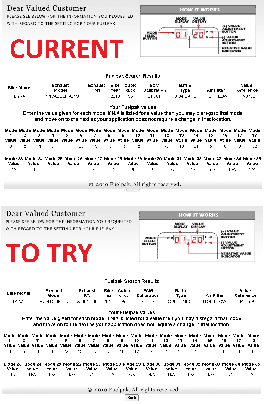

I ran the FuelPak numbers. Compared them.
Top is what's in there now. Bottom I'm going to punch in tomorrow. See if that has an effect. Those values vary quite a bit there.

FuelPak came with the bike and I've never used one before so I'm still fumbling around with it. I do see mixed reviews with it.
Its just as simple as unplugging it and replugging the ECM back in right?
