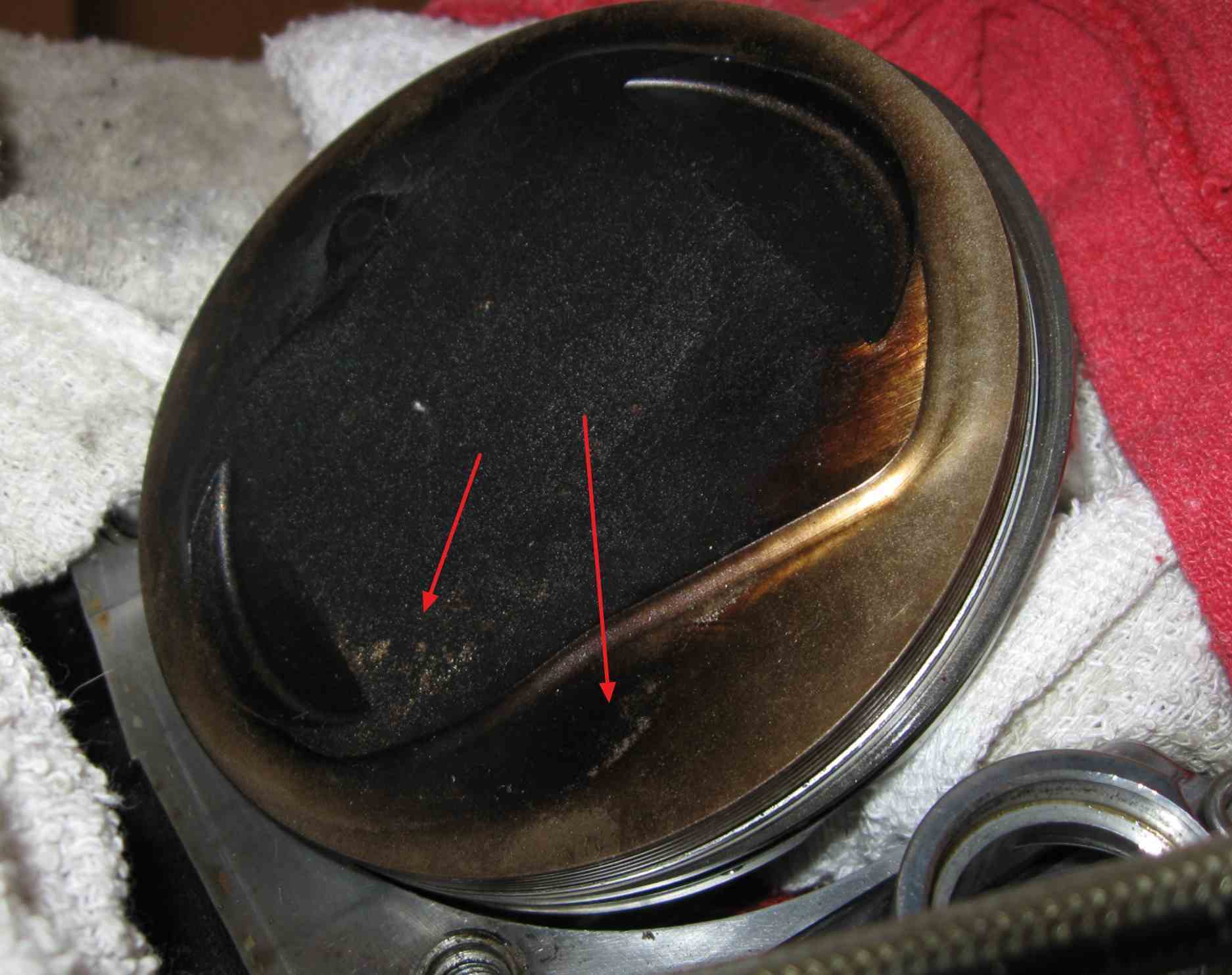

Originally Posted by xcbullet
Looks like detonation on rear cylinder, thats why its cleaner. Not destroyed yet but could use a better tune.
I would ask them to look into it as its totally stock, if it was mine I would be checking injector on that cylinder .
Do you what know what detonation looks like?? Cause that's not it.. that's a lean cylinder.. Don't fill the guys head with crisp..

What are all the pits in the piston top?
Carbon flaking off? Typically when I see detonation, you can see the piston through the pits.
Here is some real slight detonation on an 11.5 to 1 131 ci motor.. Notice it's on the rear cylinder / exhaust side.
