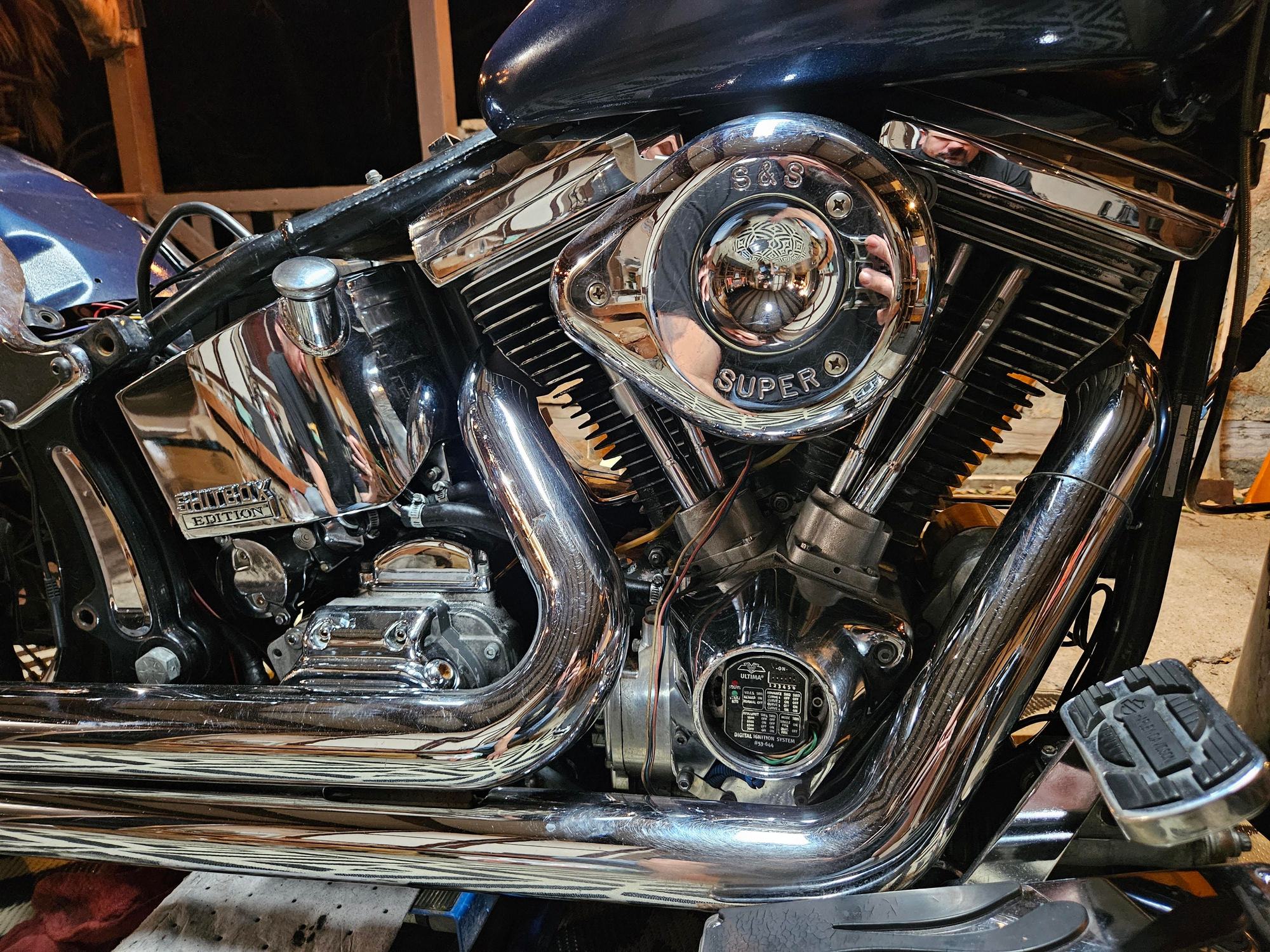

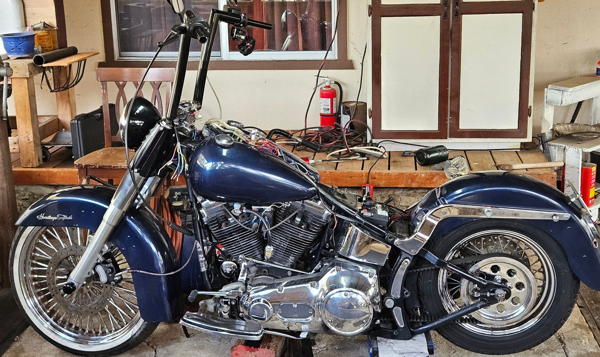

New to me, 1993 Heritage FLSTC S&S Carb, S&S oil pump,Electronic ignition.
Inner primary is cracked, that should be an easy fix. Broken throttle cable.
It runs and goes through the gears on the stand, I have not rode it yet.
The rear head gasket is blown.What head gaskets do you all recomend?

Cometic MLS gaskets and OEM HD breather valves in rocker boxes.
What makes you say the head gasket is blown? Oil leak or other issue?
If the heads have to come off, you should replace the cylinder base gaskets while you are that far in. Depending on the mileage, I have the heads rebuilt, valve job and stem seals. And I'd likely re-ring the pistons, but have the base of the cylinders checked for true (flat) so the new gaskets will seal correctly. Ad have a machine shop check the cylinder bore / piston fit and properly hone the cylinders if they are all good.
On reassembly, check the piston deck heigth and select the base gasket thickness to get the desired heigth.

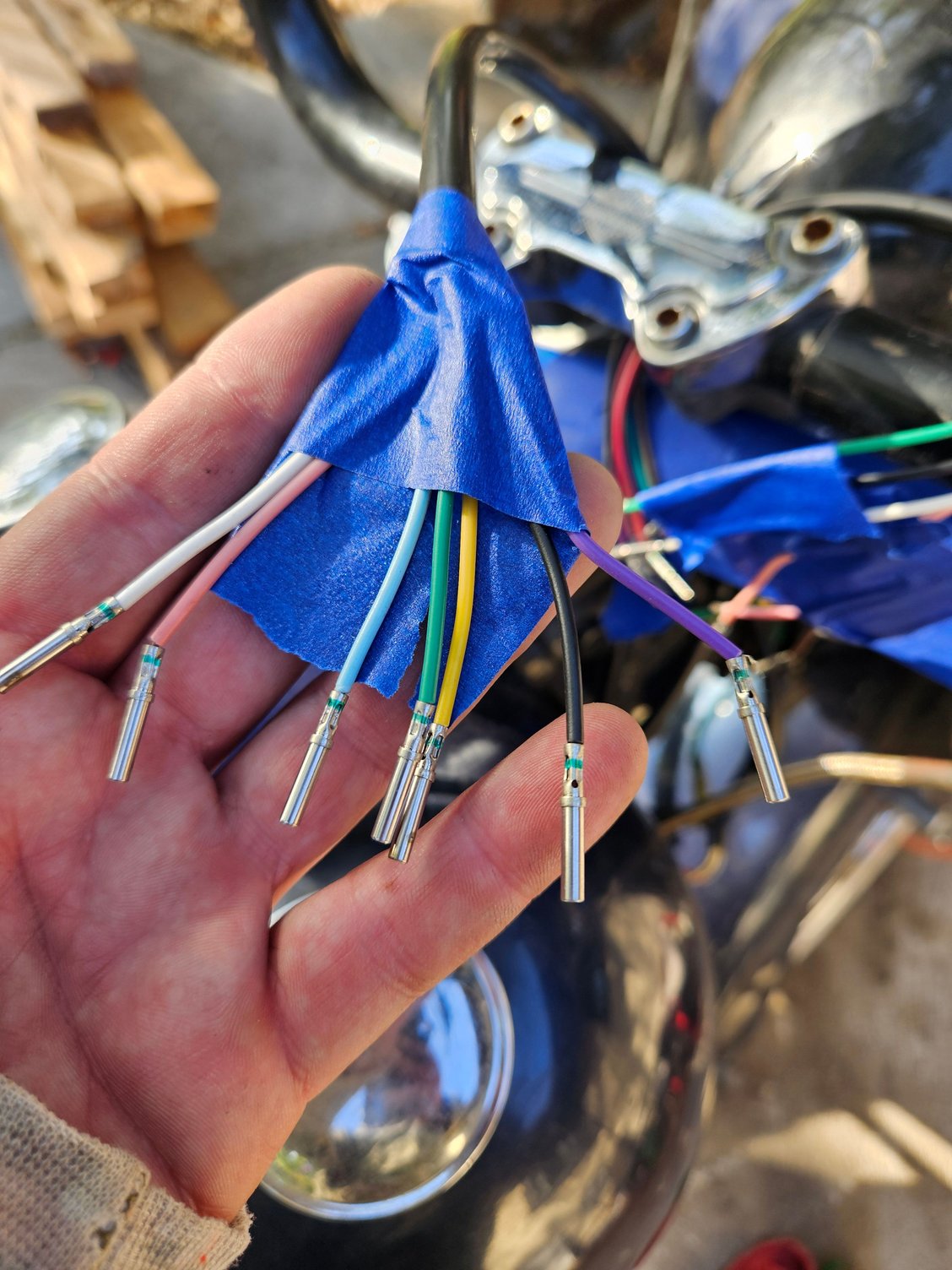

The head gasket is blow because you can see part of the gasket hanging out and feel the air being pushed out if you put your hand there.
The orignal ower blew it out. The bike was dirt cheep so i grabbed it. the wires from the bars were all un hooked and not marked so it took me a little bit to find out where they go.
Base gaskets are not leaking BUT while im in there I'll replace them.

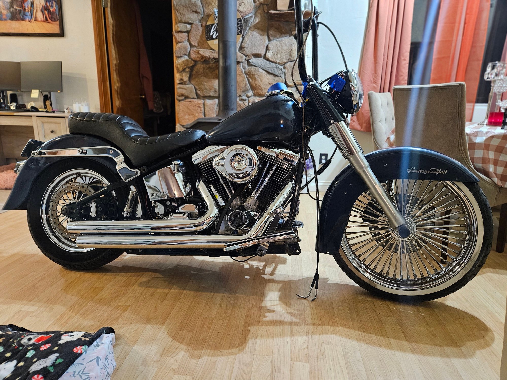

Nice but not digging the big fat spoke wheel.
