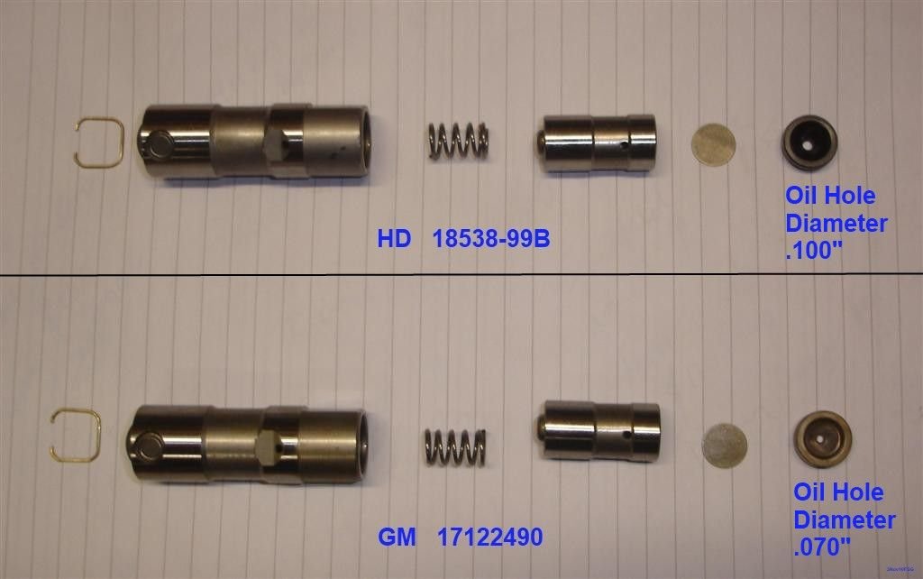

Originally Posted by djl
At one time, the only difference was the oil hole in the piddle valve and both made by Delphi; close but not identical.
The big issue changing flow IMO is the bottom of the lifter cup. I guess hole does have some but it depends more on the radious of the bump om the bottom of the lifter cup..
Here is a bottom pic of the different cups on the Delphi type lifter. The smaller the radius where the hole is the more oil that gets through to the pushrod/top end.

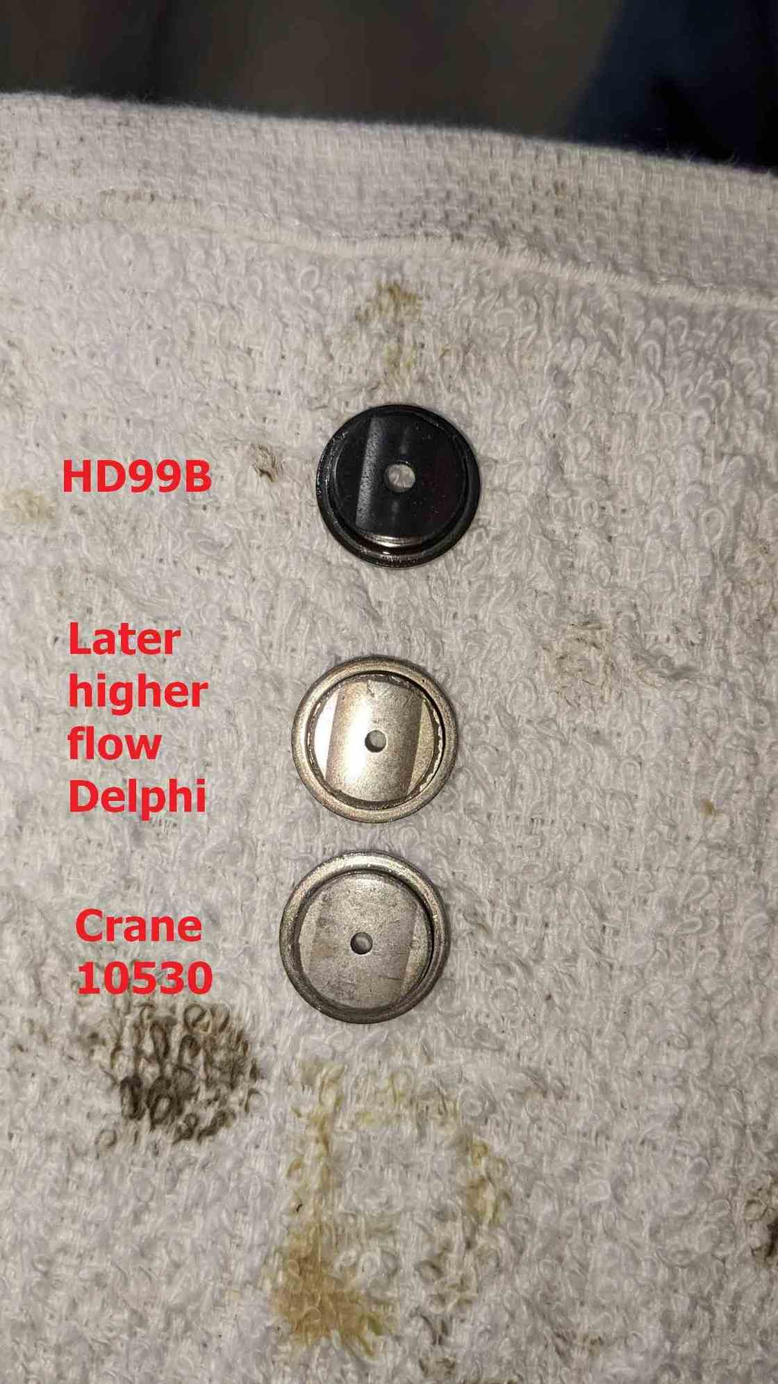

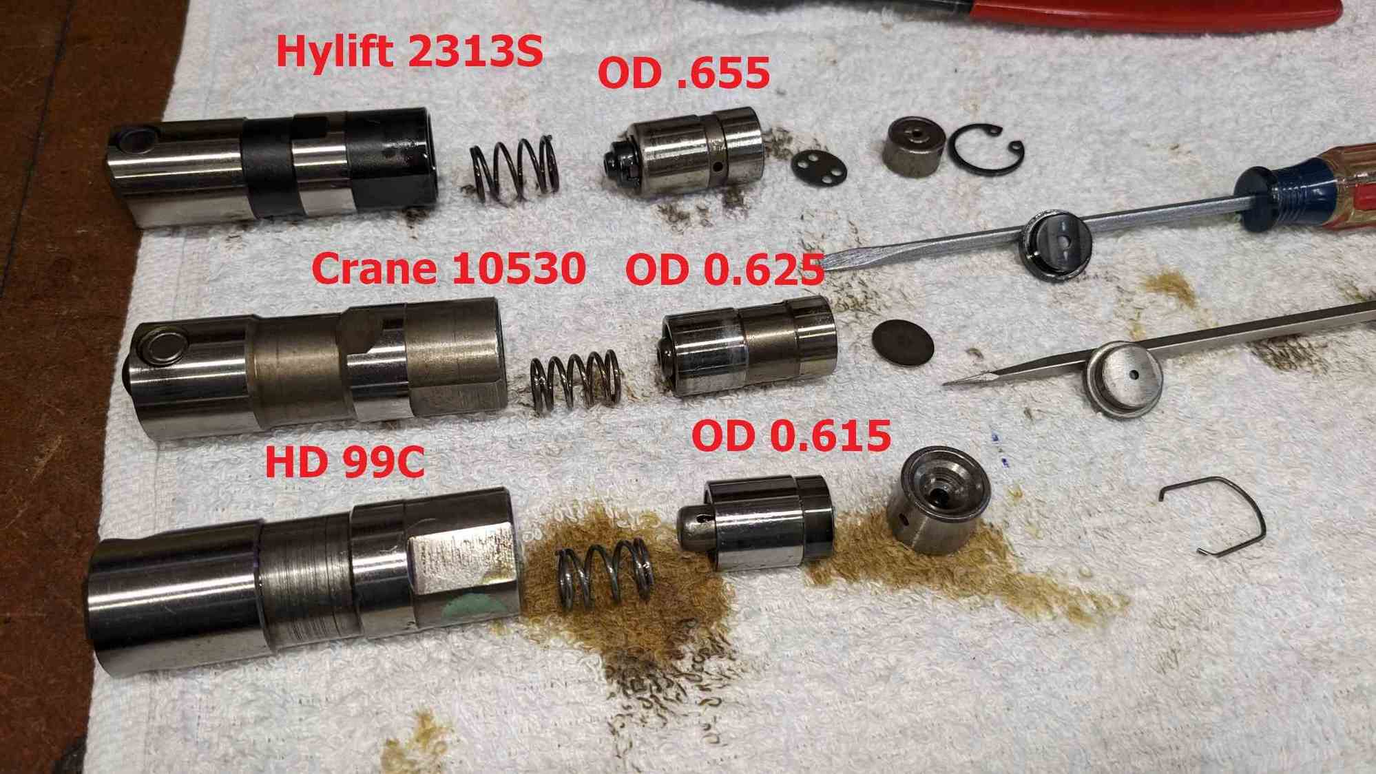

Here is a pic of the hylift which has a similar metering system as the older HD 99A.
A picture of a crane 10530 that I used with 99B lifter cup but both shown.
An the final 99C POS.
