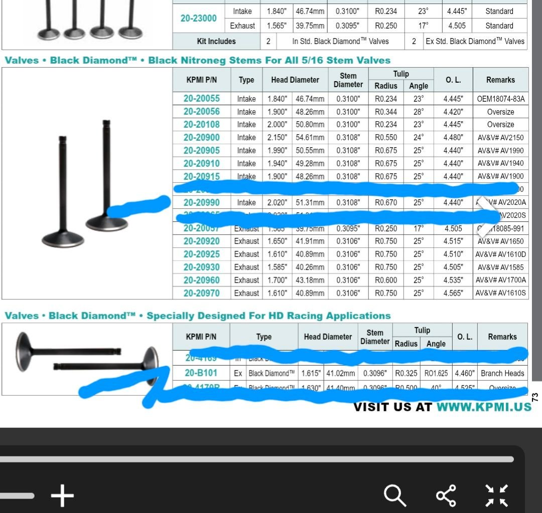

Correct, the intake rings remained the same.. I'm assuming your talking about the intake to head seals. the 2 different heads both have the ports set to 1.800" and am using an HPI intake @1.800"..
No on the valves.. I specified from the KPMI catalog exactly which valves I need to get the tip protrusion down to where it was manageable.. 2.020" intake and 1.615" exhaust.as indicated in the attached pic. 5/16" stems.. I believe they were shorter in overall length by .090"intake and .075" exhaust. Plus adding the .040" height increase to the rocker shaft when I had Vulcan custom make the rocker mount assembly's, it really helped to correct my rocker geometry not to mention the addition of the S&S roller rockers. So far all works very well and with the older tune in it, it perofrms verry nicely.

No, Stage II heads have 1.900"/1.575" with mild porting and the current Stage IV heads have the 2.020"/1.615" valves with extensive porting.
