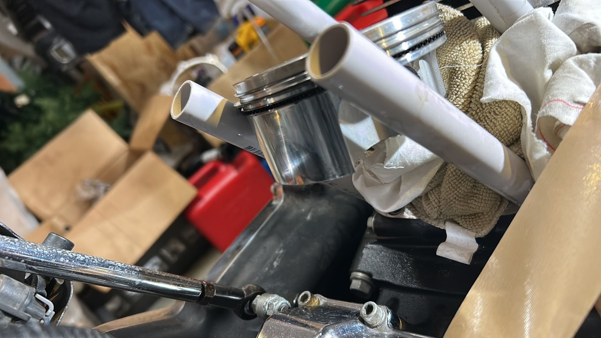

Lifted the rear cylinder today, as I wanted to clean it out thoroughly after removing carbon from the piston. The piston has rubbed against the cylinder below the rings. The guy who bored them said he could not get them “straight”, but it is only under the piston rings he said.
Here is a pic of the JE Piston:
About 10.000 miles since big bore.
