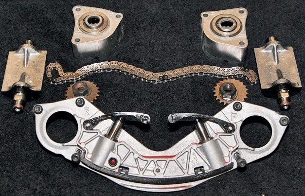

The rwo balance rotors have two hydraulic tensioners and the chain is roller. There is a small screen filter in the cam plate for the system.. Once grooved in, wear ceases.
Sure age could break one, but they're big. I have never seen a balance chain tensioner fail on here on the balance system.

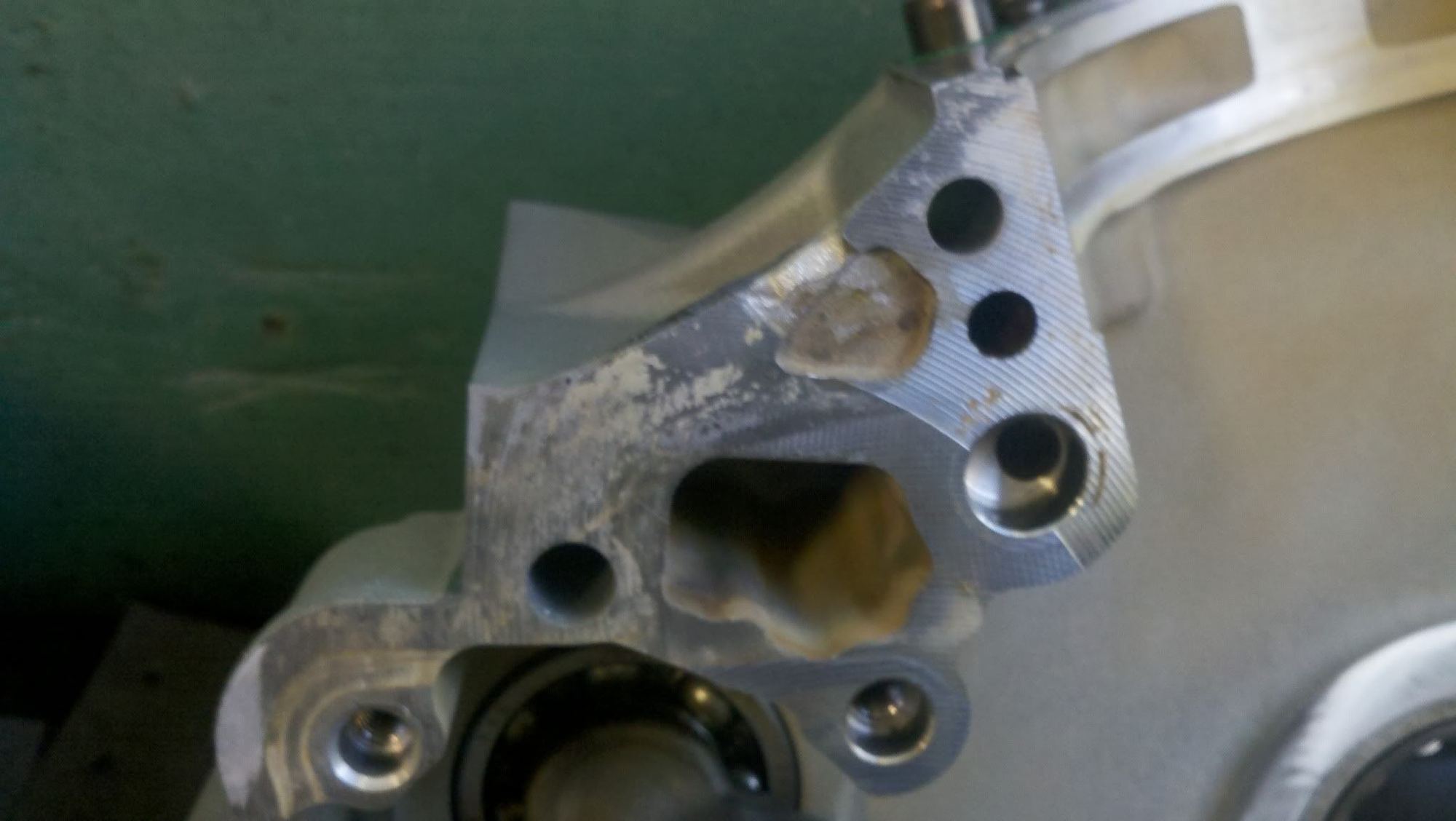

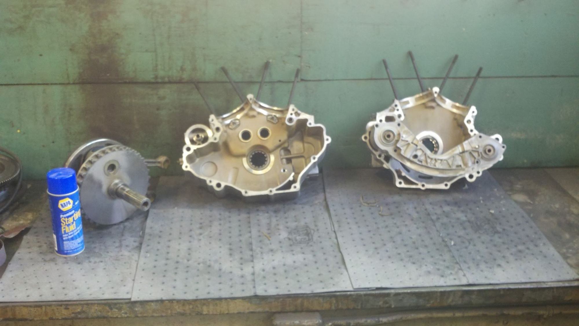

The attachments below are our out of the bike I described above. I forget USER name. Was a highly skilled heavy equipment mechanic. Did his own work in a shop. His bike developed a knock. No one could figure out what.. That issue was the pin bushing in the connecting rod had turned. Note the connecting rod has a piston clearance angle on sides of pin bore. Bushing turning, that wide width was hitting up inside the piston at the bottom of the stroke.
That one side of the case half is how the mother ship did it and put it together like that with the machine error.
