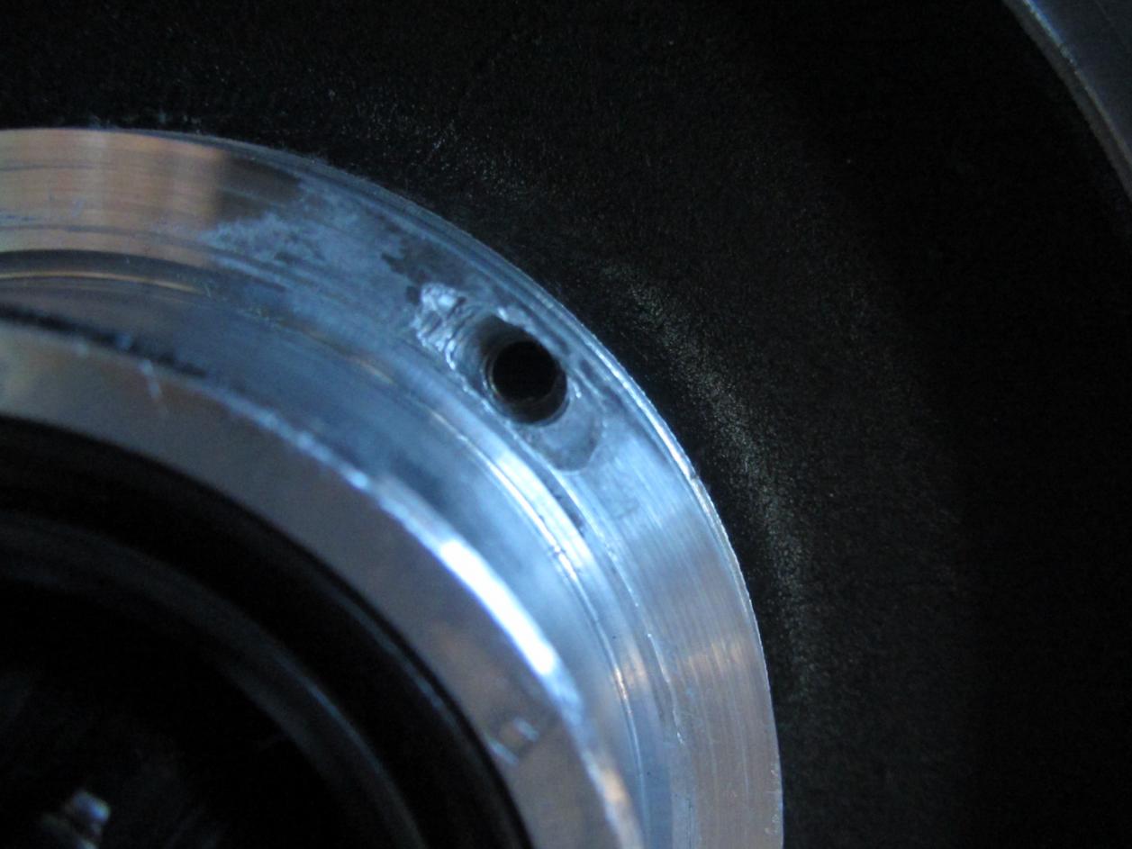

Old stator bolts with blue loctite. Engine with 125,000 miles. New bolts are cheaper and less time consuming than having to drill and tap new holes in the case. Additionally, loose bolts sheared and broken pieces took chunks out of the rotor magnets and then teeth from the starter ring gear.
Yours came out a little uglier than mine did, I had no starter ring damage. Those screws for the alternator plug retainer were the only ones I really had a headache over.
Y'all go ahead and use the old bolts if you must, I certainly won't ever do it again. Those #10's see a bunch of heat.
Wow,that really sucks. Hope mine hold until I rebuild my motor. Plan on replacing a lot of hardware with ARP.
