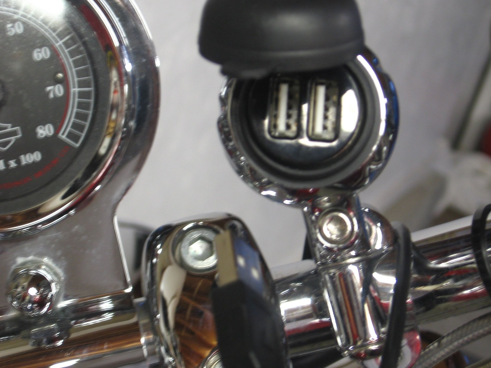

I wired mine (fused) direct to the battery. I like to able to charge stuff when the bike is parked.
