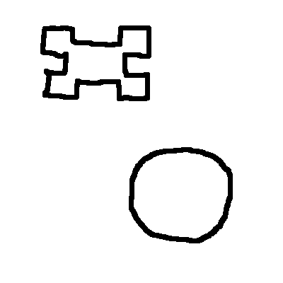

It sure is funky lookin' ain't it? Like I said, it was 4 extra o-rings in the package and I figured they must have been some kind of 'upgraded' o-ring. I sure hope it's those things that *is* the leak.

Originally Posted by tar_snake
Here's a really bad drawing of the cross section difference between the two o-rings (I did it with my mouse and it's close enough to get the idea across, heh) and some pictures. The circle in the top picture is the cross section of a regular o-ring. Both of the o-rings are the same inner and outer diameter and same thickness.
It's not so much I don't like the sound, it's just different and I have to get used to it. It's hard to explain why that makes it harder for me to just be able to listen to it and be able to tell when it's idling at 950-1000 rpm's...I can do the same with any carbureted Chevy motor I6 or V8, but ask me to tell what a Ford or Dodge is idling at and I'm usually pretty far off, by something like 300 or 400 rpm's. I just have to spend time around this cam is all and it'll settle in soon enough. I'll hook up my timing light that has a tach in it and that'll get me started on the right track.
The old quad rings LOL!!! Those weren't one HD's better idea's, late shovels and early evos' used those for a bit, still have a bunch in my gasket stash. Dump them and use the regular o-rings you'll be better off.

Those wark better in a pneumatic system, than tring to hold back hot oul. Though both are meant to cope with low pressure, I would trust the natural swuish of a round buna style than a quad or x ring. Unless I had a ton of them to try and see which combo worked best.
In this case, I’d just stick to the old tried and trued.
