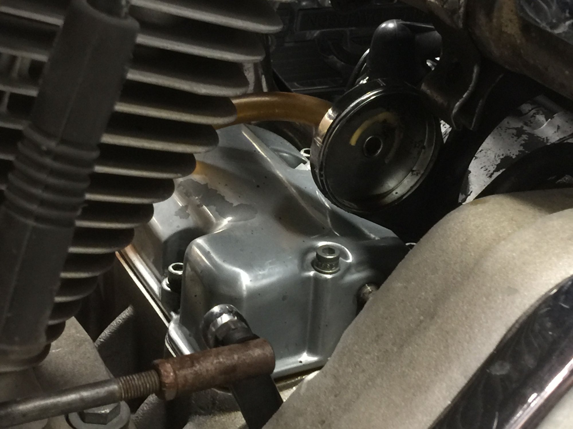

I have inherited a 1992 Harley Davidson Electra Glide sport and noticed the oil tank was completly empty i filled it up , charged the battery and when i cranked it over there is a hose running from left of engine to right with a chrome cap and nothing on the end of it just blowing oil out . what is supposed to be there ?

Sounds like too much oil for one thing....

On older bikes, the oil can leak from the oil tank to the crankcase. When you started it, the oil in the crankcase was pumped in to the oil tank. Since the oil tank was just filled it had no where to go, so it blows out the vent. You'll probably have to pull some more out of the tank to get to the proper level .

This is where the oil came from. I only put 3 quarts in in and it was completely empty

You made the same mistake as every other person who does not know the oil systems on these bikes. Including me lol.
You probably over filled it by the amount you added. I would drain it out and start over.

But is there something missing on the chrome cap in the first picture?

Just a guess but isn't that year evo crankcase vented? So maybe that's supposed to have a breather filter on it? But it still shouldn't be leaking oil out of it,so must be something is plugged or stuck open somewhere on the oiling system. Another guess but isn't there also a timing gear for the crankcase vent? Maybe thats not working...definitly sounds like something is just not right and the bike has probably been sitting too? Someone with real answers will be here soon to help you out...lol.
