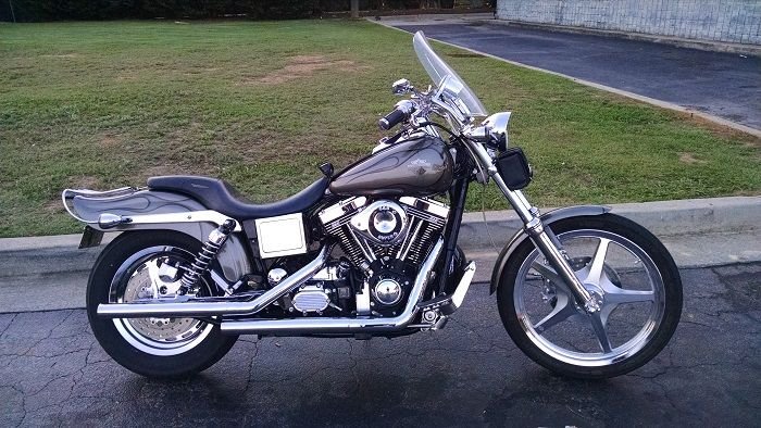

I want to lower the rear of my 97 WG and the question is if I get a shock 1/2 inch shorter will it lower the bike 1 inch? I think the stock rear shock was 12 inches from center of eye to center of eye. Picture included for input.

I think 11.5 shock will drop it an inch still ride good and not be like a rigid.

If you are considering something like JRI's or Ohlins, they are set with a additional 1" sag and lowers more, cost me a taller seat because 1 inch is 2 inches but the JRI's ride was plush over a 1" lowered Progressive. Would think a 1" drop eye to eye would still be 1" on a light bike, just don't get into bottoming out and having to crank the spring pressure up, ride may get old after a while.

I dont really want to drop $800 on ohlins I just wanted to lower the rear 1 inch without getting a rough rider if possible. I have a thin saddle and a touring saddle and like both so their not going away.
The 444 Progressives I have now measure 12.5 center to center which seem to be an odd 1/2 inch size.

Yea, that is understandable, I found a set of JRI shocks for $435 and the adjustable shocks are better for a bagger, just letting you know they sag another inch on set up if you was going that direction.
With a light bike and non doughnut eating rider you can most likely get away with a 1" drop without running up the spring pressure affecting the ride. On baggers a 1" drop will bottom the shock out before the tire hits the fender, over 1" with non dampening adjustable shocks the tire will tear out the wiring under the fender, hopefully a light bike follows the same pattern of 1" is cool without problems. On a side note the JRI's adjustability at 1" drop 1" sag don't bottom out or hit the fender and bad azz with a great ride, found out why the upper tier shocks can be worth the money.

Many Thanks that is exactly what I wanted to know.
