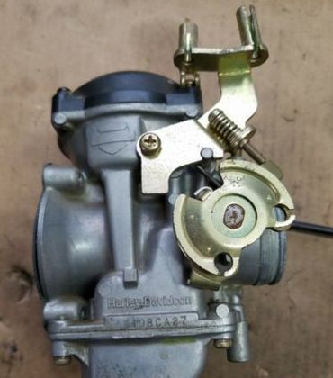

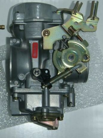

The cables will need to be for a post '89 (90-up) because of the difference of the cable-to-housing length between the butterfly and CV, so you'll have to do some research. 56343-90 and 56342-90 should work, but measure your current cables and reference with replacements for the mentioned numbers. Most all aftermarket listings will have both length and OEM number listed. Of course if the handlebars are custom, that's another variable.
With your setup, 45 (maybe) or 48 low jet, 185 main jet would be where I'd start. Just have to look at the needle to make a guess on that. This assuming the carb is stock and doesn't have aftermarket so-called "performance" mods already. Many used carbs have already been modified, but that's another chapter.
With the higher mounted tank, you might be be OK with the Sporty cable bracket. Just "dry fit" you current cables to get an idea before ordering cables or searching for the other style bracket. The first pic is Sportster, the second BT so you can see the difference where the Sporty is straight up and the others are angled inboard.
