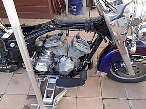

Emptied the oil the other day and she was a MESS. So this morning I got up and degreased her, after she dried out I got this far today. The lifters arrived too.

She's stripped down now. Gunna start measuring everything to see how far "out" or not everything is. Looks pretty clean, no ridge in the barrels, although they're pretty shiny inside.
