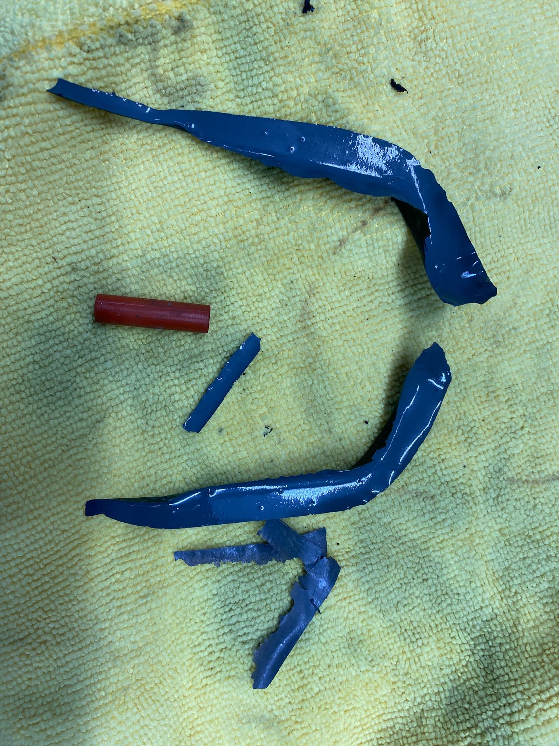

Thanks Yank! (I feel like a Brit) funny you mentioned the liner. It’s already happening. When I was maneuvering out the sender I heard a rattle as I moved the tank. I grabbed my handy $40 endoscope from Amazon and saw bits of liner. Pulled out all this:
No idea what the red thing is.
So do I need to be concerned about that?

Yes, spend some time fishing out any debris flaking off inside your tank. It will eventually plug the petcock screen and reduce your fuel flow. It's a PITA, I did two sets of split tanks in the shop this winter. Pick up a set of long hemostats - 10" worked good for me. I used the nuts and bolts shaking method to start, went thru several cycles pulling out bits of liner. I fashioned a piece of flexible copper tubing to the air compressor nozzle and shot high pressure air into the areas away from the fill neck, then back to the nuts and bolts. Keep pulling out fragments until your satisfied there aren't any more hat will flake off easily. When you get bigger pieces use both hemostats to grab them when you pull them out of the neck, if you use one the brittle liner can break and fall back into the tank. I rinsed it several times with soapy water then used alcohol at the end to help any residual water followed by the air nozzle again. We did not re-coat the tank with a liner at the owners request.
I'd stay away from anything corrosive for cleaning because it can remove enough rust to cause pinholes to start leaking. I learned this the hard way trying to clean out heavily rusted and scaled water lines - wound up replacing all the lines.
