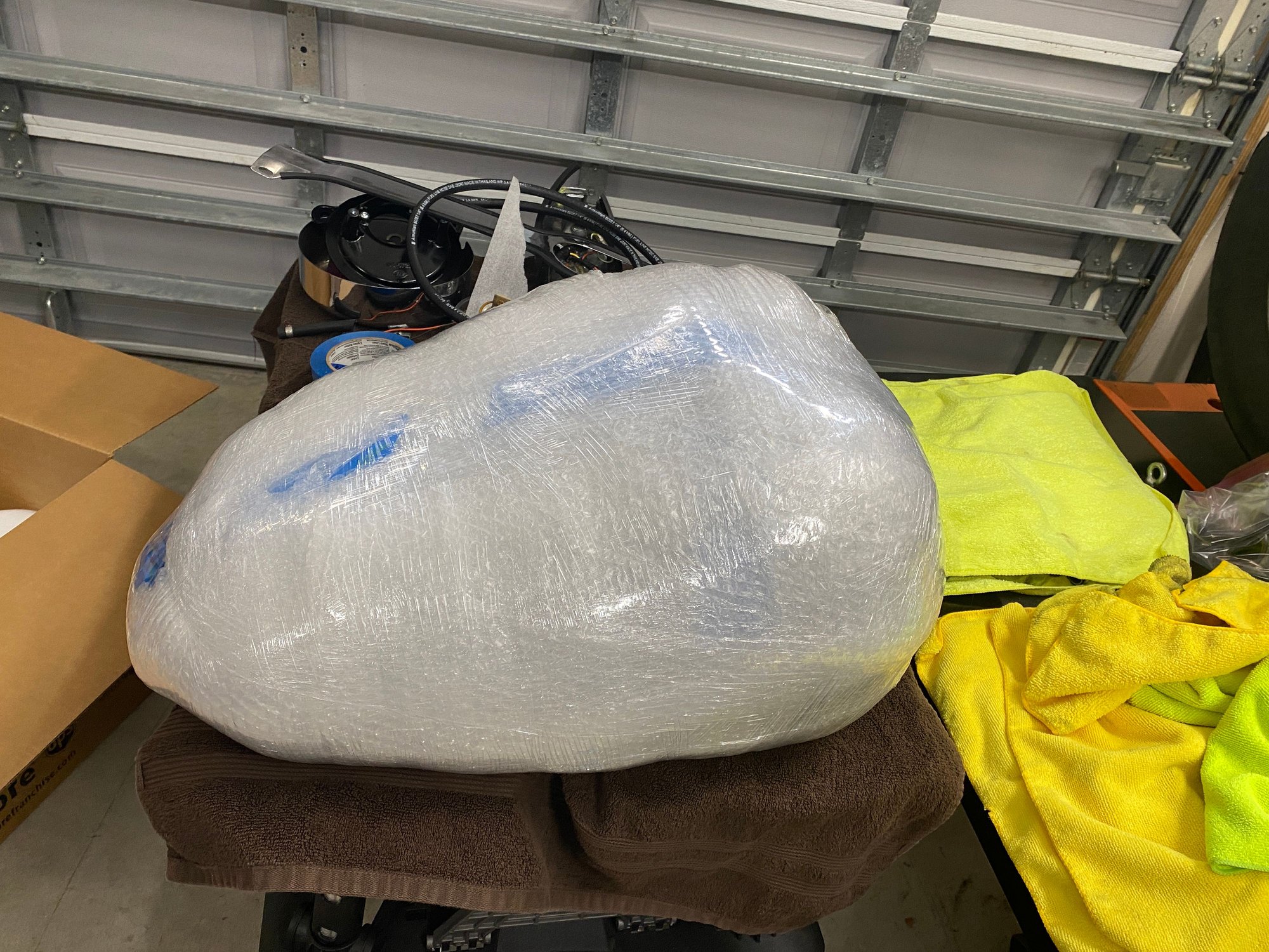

Old Mar 12, 2022 | 03:05 PM
Mchad's Avatar
Mchad
Joined: Dec 2014
Posts: 10,734
Likes: 3,755
From: SWFL
It’s all wrapped up and ready to go to a PDR guy to get this dent out. Once that’s fixed I’ll deal with the touch up spots.
