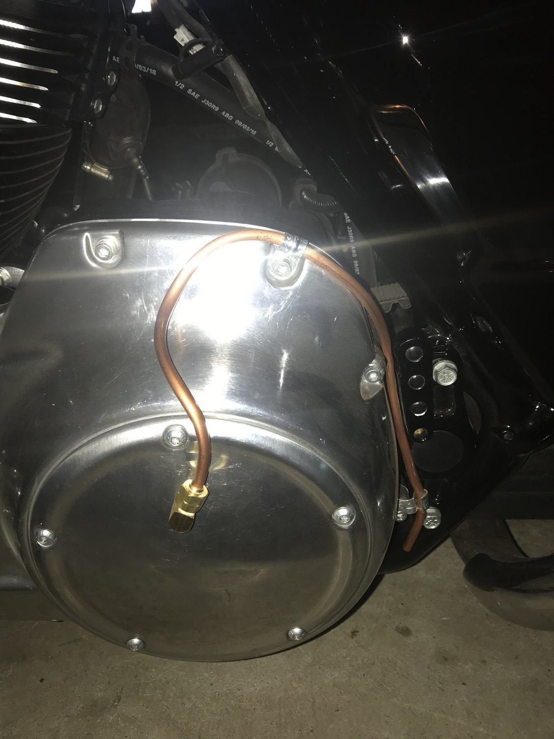

Here ya go! Works great, no issues, only about 10-15 bucks at home depot.
Seriously, It's an interesting topic. It makes sense and has me curious. There are some posts over on the M8 sub-forum. It seems that some have played around with primary venting because of the early M8 oil transfer issues. Might want to snoop around there to get some ideas.

Thanks for the pic and info... That setup is like having an outhouse in this day and age when we have indoor plumbing...... Yut, sure looks pretty...
