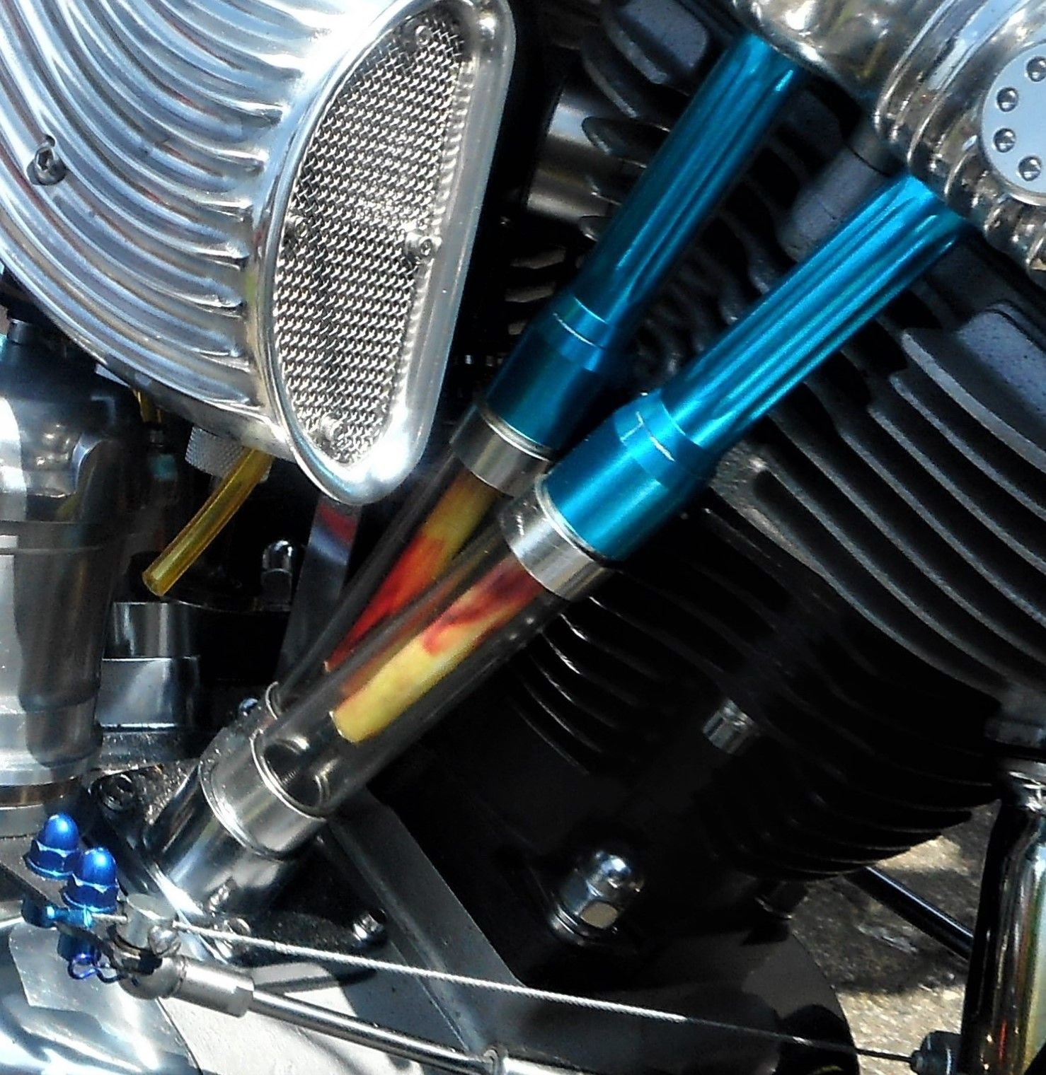

i run an open primary on my Shovel & to stop any oil mess when timing I had a degree wheel sticker made & installed it on the front pully, really made timing easy & fast, I also use glass pushrod covers so finding front compression stroke is also an oil free process as ya dont disturb the seals,
could this help if fitted to the Compensator Sprocket on your Evo ??
