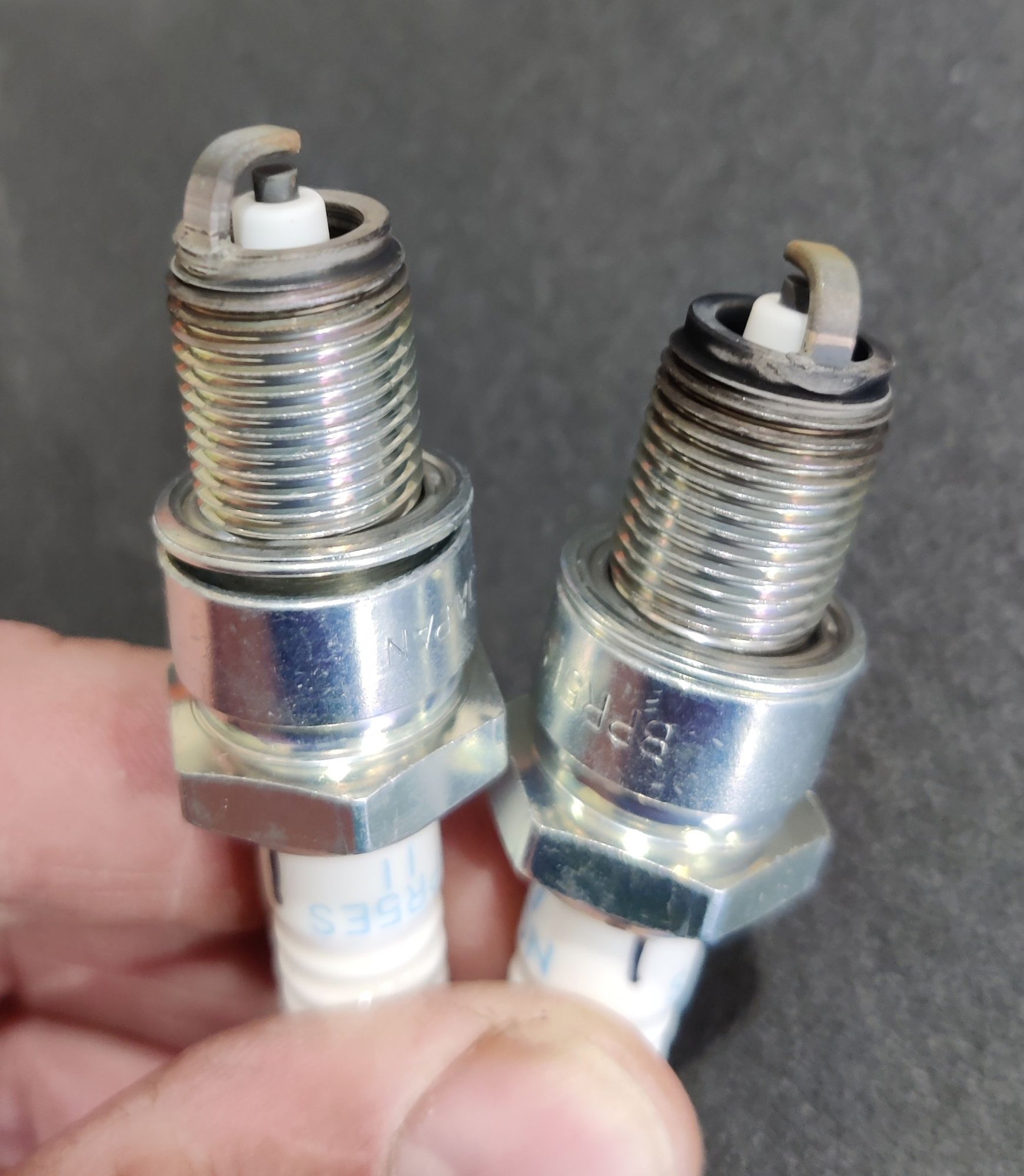

Hey Don, I've never timed mine like that but it should be very accurate.. It actually can't think of a better way.. I truly don't think that the status light on after market devices are as accurate.. I will after riding for about 20 miles pull the plugs to check the ground strap for the timing mark.. middle of the strap is where you want to be.. Sometimes when I'm in a hot riding mood I'll advance another 5 degrees on the base and man it's a pleasant difference.. Always check the plugs after that though for any peppering down inside the plug on the porcelain (destination)...

Here's an example of to much timing.. However I never had destination... The motor liked it an so did I... Lol ..

Looking at the picture I posted the plug on the right you see how the timing mark is down close to where the strap is welded to the plug? Well that's a real lot of advance.. The closer it gets to that weld the more the timing is advanced.. Less timing advance would move it up the strap toward the electrode. Generally speaking you want that to be right in the center of the bend ..
If you're getting detonation when static timing with the status light and on curve 4, then I would suspect that your VOES switch is not working.. Maybe it's stuck or your running lean..
